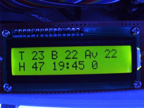

Hi Guys
I am running MMBasic V4.5 on my Colour Maximite.

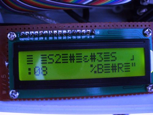

I am using the LCD function to display data in a greenhouse.
For some reason the display ends up jumbled as in the picture below.
On loading of the program it works fine but fails after maybe a day or up to several days. There seems to be nothing regular about it.
It's not a voltage problem.
I have tried:
purchasing and installing a new display
installing additional filtering on the supply
10k pull ups, even though the manual says it does not require them.
clearing the display before a write. The display still remains jumbled after receiving new data.
I was going to use the LCD program that is in the library as another option but figured that this would have been put into the microprogram by Geoff.
Any ideas and has anyone encountered this and what was the fix?

Is this an I2C or SPI driven display or the parallel interface (using the MMBasic command?) I suspect the latter..
My guess would be that you `might' be powering it off 3v3 instead of 5v, if so these displays usually only run off 5v but some `may' appear to work off only 3v3..
A suggestion that might work would be to re-initialise the display just before every write.
Can you add a small delay after every write? Have you tried a different brand of display module?

what is the distance between the LCD module and the maximite?
i see from the version 4.5 language manual that the maximite supports the command:
LCD INIT d4, d5, d6, d7, rs, en
to initialize a 16x2 LCD module. you may wish to try executing this command every hour or two within your code in case the module simply 'gets confused' at some point. initializing the module periodically should cause no harm.
rob :-)Edited by robert.rozee 2016-01-15

I think Rob's reinitialisation idea is the way to go. The 16x2
LCD's have to be put into "nibble" mode to use the minimum
connections. If the lcd resets and runs in byte-mode instead
it will show gibberish as it interprets the nibbles as bytes.
Sometimes 16x2 modules do not power-up cleanly unless the rise time is
in a set range and so have to be reset with a defined sequence
for reliable results, and then initialised after that.
As an experiment I'd add bypass/tank capacitors to the lcd power supply,
close to it, and see if it makes any difference.
(ed) arrgh - was typing but rob got there first !Edited by chronic 2016-01-19

My thought/question is, what 'refresh' rate is Chris using?
I have found if you flood these displays updating them too often, i.e. every program loop, you can get a garbled screen after a varied period. I only write to the screen when the information changes.
Anthony.Edited by ajkw 2016-01-20

Hi Guys
As I mentioned I would try the re-initilization of the LCD every 1 hour.
I found this worked and had only one occasion where the display was corrupted. Viewing after an hour or so and re-initialized it was again correct.
I thought this was a way around the problem but I really wanted to fix it correctly.
I took Big Mick's suggestion and purchased some level translators. So cheap I decided to purchase 10 small PCBs. Cost less than AU$5.
Wired them in and thought this will finally fix it.
After a day of corruption free running "bah humbug" corrupted again.
So I have gone back to Robert's idea and re-initializing every hour.
