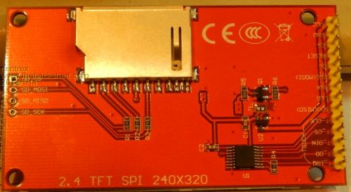

Posts: 12183
Posted: 11:21pm 12 Jan 2016
Cliff
Can you post a detailed picture of the PCB?

matherp, here is a picture of the back of the display

The board is a little different to the ones I have but it appears J1 is open. Are you running from 5v or 3.3v.
