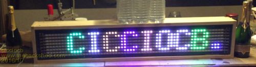

Very nice job. I did one on the same style during my christmas holidays but a little bigger (1 meter x 20 cm) with very bright RGB led strips.
I could post some pictures, if you want.

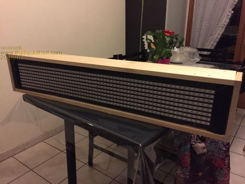

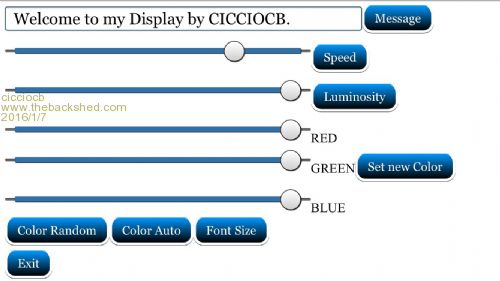

As promised, please find here some pictures;
This is the display itself:

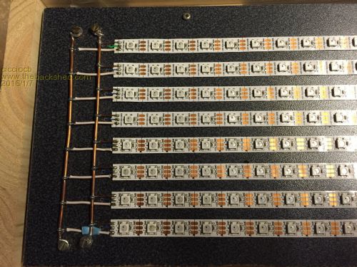

This is the detail of the led strips

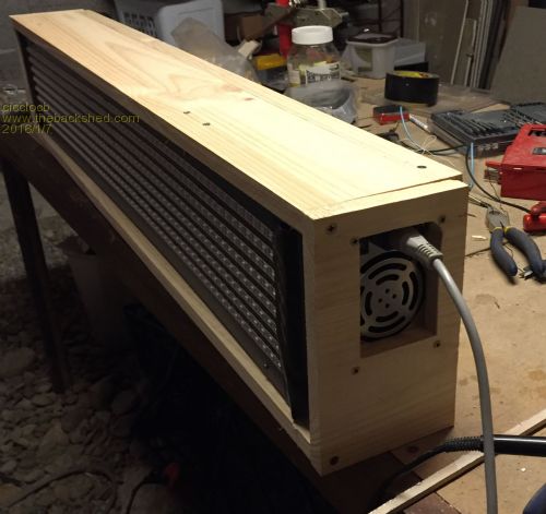

This is how is powered (with a PC power supply)

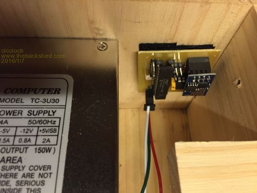

The controller (PIC + wifi module)

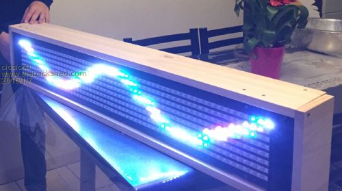

A snapshot of the web control page taken from my iphone
Some pictures
If you are really interested I can try to post a video showing the scrolling text.

That looks really good. What PIC did you use? I saw a similar LED sign recently and the builder covered the front with a cheap corrugated white plastic panel which gave the bright LEDs a interesting soft glow.
--CurtisEdited by Justplayin 2016-01-08
cicciocb
Joined: 29/04/2014
Posts: 74
Posted: 12:01pm 07 Jan 2016
The pic is a pic32mx150. I bought but not yet installed a transparent plexiglass cover.

I am curious as to how you control individual LEDs on those LED strips? Aren't all the LEDs on each strip in parallel?

cicciocb
Joined: 29/04/2014
Posts: 74
Posted: 10:18pm 07 Jan 2016
Hi Mick,
all the leds are WS2812B.
The display is simply a long strip of WS2812B, all connected in a daisy chain configuration.
The total is long daisy chain of 8 strips of 60 leds (480 leds).
As you can see from the controller picture, there is just one wire that control the entire strip (the green one).
As each led needs around 50mA at full brightness, you can understand why I installed a PC power supply (50mA * 480leds = 24A and 24A * 5V = 120W!).
I can confirm that, if I drive all the leds at full brightness, the emitted light it's very very bright.
Cicciocb
