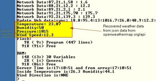

JSON weather data from http://openweathermap.org/
uMite routines snippets to parse data received from ESP8266 running ESP Basic.

if instr(buff$,"temp") then
print "Temperature: " + jsonValue$(buff$,"temp",6)
endif
if instr(buff$,"humidity") then
print "Humidity:";jsonValue$(buff$,"humidity",10)
endif
if instr(buff$,"pressure") then
print "Pressure:";jsonValue$(buff$,"pressure",10)
endif
if instr(buff$,"speed") then
print "Wind Speed:";jsonValue$(buff$,"speed",7)
endif

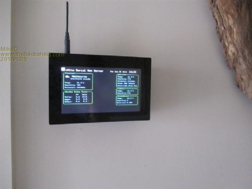

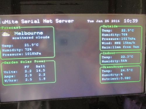

Today is Australia Day and I am President of the local community group so have so things to do until later in the day. Later today I will post some updated code, things have moved on somewhat! 7" LCD Weather from OpenWeatherMap.org , local data comprising of weather station, Greenhouse, house temp/hum and garden solar power.

Wow Mike, that looks awesome. I want to do something like this also. Bringing the uMite and esp8266 together is something that opens a lot of doors. The power of the uMite and all the great graphic capabilities available are just incredible. I have been pouring over your code and keep finding very cool methods that you implement to make things work. Still a lot to learn, but nice to know that basic is very capable!

There is also a direct live link to the ESP8266 web page , I don't think its the most robust interface but its working, showing live data from my sensors. I am please with the UMite Plus part of the project , it works great , thanks to Geoff!
It interfaces nicely with the ESP8266 fetching NTP time updates and weather forecast data from Openweathermap.org. See previous post. Enclosure by the way was purpose built to fit the 7" SSD1963 LCD from black acrylic on my CNC mill, then parts glued together. Some sensor input "fixing" , I have noticed some are missing, is next then interfacing the data to IOT primarily to monitor greenhouse sensors.

Looks cool! I couldn't help but notice the EC reading, and was wondering how you are getting that, and are you running a hydroponic system? I am in the process of creating a fully automated hydroponic controller using the Wattmon and a micromite with touch tft screen as the Hmi.
