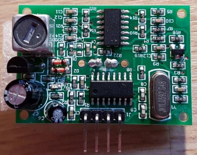

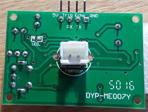

This is the link for them from ebay and the controller looks the same as the one you posted originally.
Here are some close-ups of the board - the two ICs are un-marked (of course)
Initially I expected them to be PWM devices. I bnotice the tiny green LED flickering as soon as they got power, wrote some code with the Distance CSUB and got a stream od -2's with the occasional 16.7 or similar... took the device out and replaced it with the test "twin can" stylee and the code worked immediately.

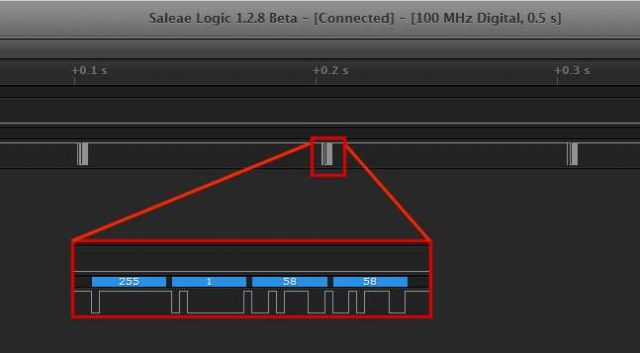

Got my analyser on the teo pins and saw the trigger pulse seemed to have nothing to do with the echo pin... stopped the code and the pulse train continued. Zooming in, it looked familiar so i applied a serial analyser and got the previous screen shot on one of them.
I chaged the code and linked the "exho" pin (which is also labelled TX) to COM1 and wrote some code and got this from it:
1 100 100 1.72414 1.36638

first column is the byte immediately after the 255, then the two numbers. I thought these might be microseconds or somehow related with the "1" but my SoS calculation (col4 and averaged over 5; col5) don't really reflect the distance - even given for echoes... Moving the sensor does vary the numbers but they are only ever "in the zone"... which I might expect for a closed environment - much the same as you found with the echoes from your water tank.
Currently, I am lost pending a PDF - I have crawled through so many pages but you can imagine the hits I get for Ultrasonic, serial, Not PWM... etc.

I have done a bit more fiddling with this and I have come to the conclusion that the output is a direct reading of milimeters.
Let's call the four bytes S,a,b,b' (Sync, a,b and b prime)
S=255, always. b' is always b +/- a few
I have a rough correlation of a*256 + ((b+c)/2) as millimeters (I actually converted to cm just to stabilize the readings a bit). It definitely seems to be giving in the right area.
sometimes (haven't been able to pin it down yet) the sensor drops to around 40cm and then that is it - I have to power cycle the unit to get it back - the trig input doesn't seem to do anything HI or LO but then I suspect it is just the RX input on the micro-controller near the plug.
It seems like it is some sort of time-out. I have seen times of 82 seconds and another of 177... if this is aimed at the automotive industry it may be a way of drawing attention to the vehicle left in reverse for a prolonged period.

There was an article in silicon chip, in the "reusing cheap modules" vein.
I don't remember many details, but one chip is a max232 type, drives the sender after trigger goes (high?). The other is a 4x opamp in a filter, detects a received burst of 8 pulses. Output goes high (? check) after a time corresponding to distance - the article has the formula.
(ed) the usual type has two transducers but I think the board is using one to send and then receive...and the serial i/o uses the trigger and receive pins ?! weird..Edited by chronic 2017-06-28
Posted: 07:59pm 26 Jun 2017
Thanks for this - I will see if I an track it down.
You are right about the 14 pin chip - it is LM324.

The photos a few posts back show the same units I have.
A pulse on the trigger starts it and the length of the echo pulse determines the distance. I have used units with 2 transducers as well as units with one. I have also used units with the trigger and echo pins combined.
The MMBasic function will work with all
BUT as usual,
there are a few modules out there in Ebay land that are different. Just because they like being difficult.
The unit referred to in the later post and with the link to aliexpress is talking about a different module that does have serial output. One of the photos in the link seems to show my twin transducer unit but there is no way it outputs serial data.
