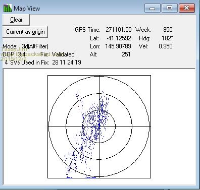

On page 67 of the users guide is this:
  Quote  Enable Track Smoothing
Enables smoothing of the calculated positions based on acceptable variances from the last calculated position. This assists in eliminating any sporadic position jumps possibly caused by multipath, for example.
Santa delivered my VK16E today so I will give it a try.
Posted: 05:06pm 08 Dec 2015
Page 71 of the users guide:
  Quote  Enabling/Disabling the Static Navigation
The steady state detection allows the navigating algorithms to decrease the noise in the
position output when the acceleration is below the threshold. This reduces the position
wander caused by Selective Availability (SA) and improves position accuracy
especially in stationary applications.
To select the static navigation mode:
1.Select Static Navigation from the Navigation menu.
The Static Navigation screen is displayed.
2.Select the option that you want to use.
3.Click Send to accept or Cancel to exit.
Note – The Static Navigation filter is Disabled when DGPS corrections are used in the navigation solution.
It did the job for me.
To use SRIFdemo, click on Action/Synchronise protocol and buad rate.
This should put it in SIRF mode.
Remember to switch it back to NMEA before exiting.

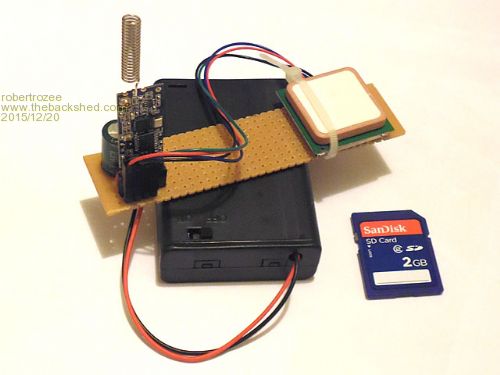

btw, i'm mulling over doing an SC construction article on differential GPS. essentially, while the GPS location of a single receiver wanders around, the difference between two GPS receivers close by provides a far greater accuracy. i want to see if i can get down to sub-centimetre resolution.
rob :-)

$B0,$B3); // footer
ds3:array [1..10] of byte= // enable static navigation
($A0,$A2, // header
$00,$02, // payload length (2 bytes)
$8F,$01, // command + SN flag
$00,$90, // payload checksum
$B0,$B3); // footer
ds4:array [1..32] of byte= // return to NMEA mode
($A0,$A2, // header
$00,$18, // payload length (24 bytes)
$81,$02, // command + mode
$01,$01, // GGA (1) (interval + CS flag)
$00,$01, // GLL (interval + CS flag)
$01,$01, // GSA (1) (interval + CS flag)
$05,$01, // GSV (5) (interval + CS flag)
$01,$01, // RMC (1) (interval + CS flag)
$01,$01, // VTG (interval + CS flag)
$00,$01, // MSS (interval + CS flag)
$00,$01, // <unused>
$00,$01, // ZDA (interval + CS flag)
$25,$80, // baud rate (9600)
$01,$3A, // payload checksum (0x013A)
$B0,$B3); // footer
var put:DWORD;
i,c:integer;
begin
WriteFile(ComFile,ds1,length(ds1),put,nil); // switch to SiRF mode
sleep(200);
Application.ProcessMessages;
if CheckBox1.Checked then WriteFile(ComFile,ds3,length(ds3),put,nil)
else WriteFile(ComFile,ds2,length(ds2),put,nil);
sleep(200);
c:=0; // needed if we change any of the sentence settings
for i:=5 to 28 do inc(c,ds4); // recalculate checksum on ds3
ds4[29]:=c div $100; // insert high byte
ds4[30]:=c mod $100; // insert low byte
WriteFile(ComFile,ds4,length(ds4),put,nil); // return to NMEA mode
sleep(200)
end;
rob :-)
