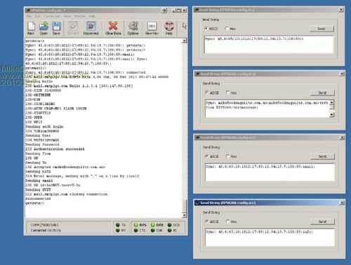

Here is my "proof of concept" code from a uMite connected to a ESP8266. The code "randomly" ? responds to the ESP requests for data + command field. In this test the ESP8266 responds with NTP clock data , status info and sends an email with data provided by the uMite. The uMite can ofcourse update its internal clock with the NTP data. 10 fields of data are also sent at each transfer in my case they will be garden data from my Greenhouse, Weather station and Solar PV generation. A very simple web interface in the ESP displays the "Garden" data but could also be sent to IOT etc.
Emails will be able to provide status update.
uMite test bed code below and Esp8266 code link was in previous post

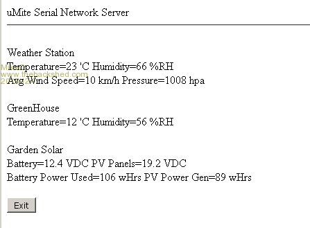

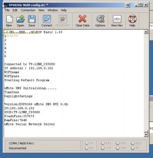

I have just posted my completed software for this project on ESPBasic which I have repeated here.
I have now completed a working version of the ESP8266-MCU Web interface. The following functions are provided.
Multi data field output, software captures these fields from the MCU and makes them available to the WEB GUI, current software has 10 fields but more or less may be configured
Format, sync: field1:------field10:cmd:crlf
A command may also be sent on its own line as cmd:crlf
Commands are in the following format
"Send Email" email:crlf then on the next line sync: to_address:reply_address:subject:body:crlf
"Send Thingspeak data" ts:crlf then on the next line sync: key:fieldnumber:fielddata:crlf
"Change Network" net:crlf then on new line sync: name:pasword:ip:gateway:mask:crlf
"Network Time" ntp:crlf requests NTP time info
"ESP System info" info:crlf requests system information network name,IP,freeram,freeFlash
"ESP reboot" reboot:crlf restarts the ESP8266
"ESP quit" quit:crlf quits the ESP software, useful during development.
A constant stream of information is sent from the ESP including responses to above commands , this data may be parsed by the connected MCU.
This software needs ESPbasic 1.65 or greater, needs new serial port commands.
Thanks to Mike for ESPbasic and being extremely responsive to change requests.

'put your web GUI code here
cls
wprint "<head>"
wprint "<meta http-equiv='refresh' content='15;URL=/input?'>"
wprint "</head>"
print "uMite Serial Network Server"
print
wprint "<br>"
wprint "Weather Station"
wprint "<br>"
wprint "Temperature="
wprint htmlvar(otemp)
wprint " 'C "
wprint " Humidity="
wprint htmlvar(ohum)
wprint " %RH"
wprint "<br>"
wprint " Avg Wind Speed="
wprint htmlvar(ows)
wprint " km/h"
wprint " Pressure="
wprint htmlvar(opres)
wprint " hpa"
wprint "<br>"
wprint "<br>"
wprint "GreenHouse"
wprint "<br>"
wprint htmlvar(gtemp)
wprint " 'C "
wprint " Humidity="
wprint htmlvar(ghum)
wprint " %RH"
wprint "<br>"
wprint "<br>"
wprint "Garden Solar"
wprint "<br>"
wprint "Battery="
wprint htmlvar(bv)
wprint " VDC "
wprint " PV Panels="
wprint htmlvar(pvv)
wprint " VDC"
wprint "<br>"
wprint "Battery Power Used="
wprint htmlvar(bp)
wprint " wHrs "
wprint " PV Power Gen="
wprint htmlvar(pvp)
wprint " wHrs "
wprint "<br>"
wprint "<br>"
button "Exit" [quit]

[getinfo]
serialprintln ""
serialprint "Version:"
serialprintln ver$
serialprint "IP:"
serialprintln ip()
read "WIFIname" blaWIFIssid
serialprint "SSID:"
serialprintln blaWIFIssid
serialprint "FlashFree:"
serialprintln flashfree()
serialprint "RamFree:"
serialprintln ramfree()
return

So to recap.
Connect up your ESP8266 via serial adapter, in boot mode program the module with ESP Basic 1.65 or greater.
Remove the boot mode link
Restart the module with the terminal program connected set up at 9600 baud.
After it has started up program with the uMite WUI software.
If you have not previously setup network connection (ie you are still using AP mode) you can enable line 5 in the program with your network details.
'connect "Network" "password" "IP"" "gateway" "mask" , you don't need to fill in the last three fields unless you are using a static address, then when the software runs it will set up your new network connection.
Run the software.
If all your hardware it set correctly you should see all the boot up and initializing messages on your terminal. Like this...
If you get this then all is good!
You should then see every 6 secs the following, as the software polls the serial port via the input "getdata" command. Due to the new "Serialtimeout" command it is just terminating looking for an input after the period set in the serialtimeout command in this case 3 secs.

Now you can start sending data and commands via the terminal program. On a new line type info:crlf and the response from the ESP8266 will be,
Command:
getdata:>
info:
info: LineLen:6
Packet:info: info
Command:info
Version:ESP8266 uMite SNS WUI 0.6b
IP:192.168.0.102
SSID:TP-LINK_C95080
FlashFree:357675
RamFree:7200
likewise if you type ntp:crlf
Command:
ntp:
getdata:>
ntp: LineLen:5
Packet:ntp: ntp
Command:ntp
NTP:Thu Dec 10 13:47:49 2015
To send an email (provided you have to set up the emailsetup command in the program).
type...
email:crlf
sync: mike@codenquilts.com.au:mike@codenquilts.com.au:test from ESP8266:test:crlf
and the response will be something like this.
email: LineLen:7
Packet:email: email
Command:email
getemail:>
sync: mike@codenquilts.com.au:mike@codenquilts.com.au:test from ESP8266:test: Send to:mike@codenquilts.com.au
connected
220 mail.smtp2go.com ESMTP Exim 4.86 Thu, 10 Dec 2015 02:57:05 +0000
Sending hello
250-mail.smtp2go.com Hello 1.2.3.4 [203.147.99.198]
250-SIZE 52428800
250-8BITMIME
250-DSN
250-PIPELINING
250-AUTH CRAM-MD5 PLAIN LOGIN
250-STARTTLS
250-PRDR
250 HELP
Sending auth login
334 VXNlcm5hbWU6
Sending User
334 UGFzc3dvcmQ6
Sending Password
235 Authentication succeeded
Sending From
250 OK
Sending To
250 Accepted <mike@codenquilts.com.au>
Sending DATA
354 Enter message, ending with "." on a line by itself
Sending email
250 OK id=1a6rPr-kaUEES-9u
Sending QUIT
If you follow this you should get the idea how to use the ESP program when connected to a Mite! Let me know how you go on.
