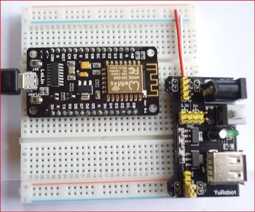

I also bought a nodemcu lolin example of ESP8266 as shown. The module unexpectedly stretches EXACTLY across the working surface of a breadboard, which seems the most ludicrous design a dip chip could have for a breadboard.
I have conquered that by butchering 2 mini boards as shown. I am proud of my ingenuity, and although I must be careful, the setup seems to work successfully.

I also have a NodeMCU v0.9
I noticed it is too wide for a single proto board. I also do not like the fact that you need to push the reset/flash button every time you try to compile/load something in the arduino IDE.
I recently received the v1.0 of the nodeMCU. It has the square USB chip instead of the rectangle. The board is narrow and you get proto board holes on each side. It also does not require you constantly push reset/flash. Much nicer board for about $1 more.
I prefer the v1.0 board for dev work.
