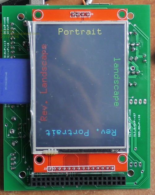

One thing we lost with the way Geoff has implemented TFT suppport is the ability to change the screen orientation in a program and therefore the ability to display text rotated away from its normal orientation.
The code to demo scrolling included the ability to send setup commands to the ILI9341 controller so it was easy to modify this to change the screen orientation and using the hooks Geoff has put in the Micromite firmware to also let the firmware know the orientation has changed.
The attached code simply demonstrates how to use the "orientation" Cfunction that solves this. Note how the first call stores the original orientation. This is important if you are using touch as the touch input positioning will be incorrect when the original orientation is not set.
The code only works on the ILI9341 but has been tested on both MM2 and MM+.
The Cfunction code is also attached for reference
dim i%,original_orientation%
cls
original_orientation%=orientation(1) 'change to landscape but store original orientation
text MM.HRES\2,0,"landscape",C,,2,rgb(green)
i%=orientation(2)
text MM.HRES\2,0,"Portrait",C,,2,rgb(yellow)
i%=orientation(3)
text MM.HRES\2,0,"Rev. Landscape",C,,2,rgb(red)
i%=orientation(4)
text MM.HRES\2,0,"Rev. Portrait",C,,2,rgb(cyan)
i%=orientation(original_orientation%) 'restore the screen to how it was set up to match the touch calibration
end
