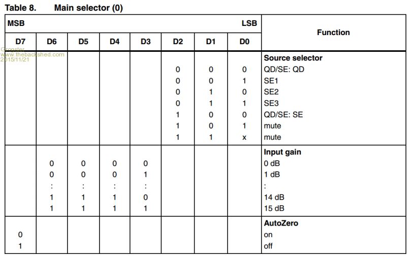

Take the following snippet from the manual:
As you can see, this byte consists of several things you can adjust, those being the input source selector, the input gain, and the AutoZero feature.
I understand how all this changes to get you what you want, but what I DON'T understand, is the mathematics behind how you manipulate the bits of the byte to get the final byte you send off to the device with the settings you want.
Take for example, the case of wanting SE1 input, 3dB input gain and AutoZero off.
This would result in a final byte of &B10011100, or 9Ch(156 decimal).
That's fine, and I follow all that just fine, but the problem I am having is in working out HOW you combine the values into the one byte.

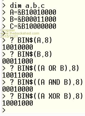

When working with bits it is best to use BIN as you are doing.
You need to understand the basic BIT operations - AND OR and XOR
AND, if both bits are set (1), the result is 1
OR if either bit is set, the result is 1
XOR if one bit is set (1) and the other not set (0), the result is 1
There is no 'carry' and the operation is done on each bit independently.
try this code:
A=&B10010000
B=&B00011000
C=&B01000000
PRINT BIN$(a,8)
PRINT BIN$(b,8)
PRINT BIN$(c,8)
PRINT ""
PRINT BIN$((a OR b),8)
PRINT BIN$((a AND b),8)
PRINT BIN$((a XOR b),8)
PRINT ""
PRINT BIN$((a OR b OR c),8)
PRINT BIN$((a AND b AND c),8)
PRINT BIN$((a XOR b XOR c),8)
PRINT ""
PRINT BIN$(((a AND b) XOR c),8)
PRINT BIN$((a XOR (b XOR c)),8)
All the BIN$ stuff just makes the code harder to follow but is need to see the results.
When you start working with more than 2 numbers, use brackets so you are certain of the order in which the operations are performed. There are too many correct ways of doing it - it is the sort of thing that starts heated discussion.
JimEdited by TassyJim 2015-11-22

  Grogster said  Take for example, the case of wanting SE1 input, 3dB input gain and AutoZero off.
According to the table, shouldn't that be &B10011001
I haven't got to the end of your post yet, but hope this isn't the issue

  WhiteWizzard said  According to the table, shouldn't that be &B10011001
Yes, it should - typo - sorry.

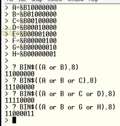

remember, the BIN$ stuff is just so that us mere mortals can see the number in binary. The computer doesn't care.
"Can you have something like ? A OR B OR C?"
See my first (amended) post .
Posts: 10109
Posted: 08:41pm 20 Nov 2015
Ahhhh - I think I am making slow progress.
Some experiments:
If I OR anything together, this would seem to put the bits where I need them.
I don't know if this is just because of the way I have setup my example or not though.

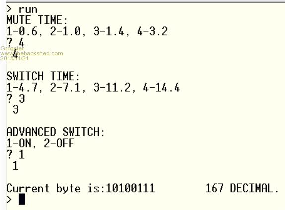

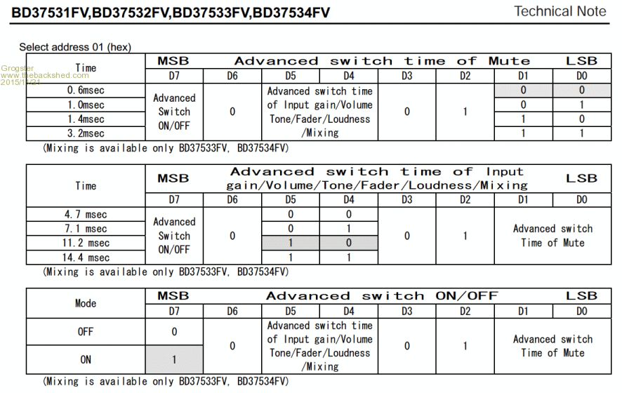

Here is a section of the ROHM processor manual:
My experimental code:
'Amp-A-Mite 2A (Rohm processor)
'November/December 2015.
Const RELAYS=&H57 'Relay control board I2C address
'GENERAL APU CONSTANTS

Print "Current byte is:";
BITE=(MT Or ST Or ASS)+4
Print Bin$(BITE,8), Str$(BITE)+" DECIMAL."
End
Done this way, with lots of constants, I can just easily or them together as discussed, and this seems to be working fine for building the data byte. The line that builds BITE, has "+4" on the end, as the data byte always has bit2 set for this command, and that also seems to be giving the correct results.
As I am keeping all the values in constants, there is no need for a sub to compile the byte as it can be done easily in one line.
