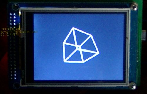

Please excuse the picture, my good camera isn't available.
This is a demo program (all in Basic) of some interesting maths that underpins all sorts of technologies like attitude/heading systems and 3D graphics.
Quaternions are a mathematical technique that allows the rotation in any direction of any shape. The maths behind it are way beyond me and extend the concept of complex numbers such that:
i*i == j*j == k*k == i*j*k == -1
I find that equation completely bemusing
However, quaternions are pretty easy to use in the real world. There are some gotchas: quaternions are not commutative e.g q1 * q2 does not give the same result as q2 * q1. But overall the calculations are pretty simple.
The attached code draws a wireframe cube and then rotates it continuously in the directions specified by the rotation quaternion.
The cube is specified as a set of coordinates around a point 0,0,0 in the array "cube". Then the array cubelines% is used to store the coordinate pairs that make up the lines that draw the cube.
The array "cubelocation" defines the actual position of the cube in space. The x and y axes are as per the display and the z axis comes out of the display towards the viewer.
The code uses a projection method of perspective to visualise the cube in 2 dimensions and "viewplane" defines the location of the projection plane in the z axis.
All quaternion arithmetic is carried out with the quaternion normalised. The subroutine "create_normalised_quaternion" takes a rotation vector and an angle and converts it into a quaternion.
Then to rotate a point we just multiply the rotation quaternion by the normalised coordinates of the point and then multiply the answer by the inverse of the quaternion. Note how in normal math this would leave the point unchanged but because of the non-commutative nature of the quaternion somehow the sequence does what we want (look at Jorge Rodriguez excellent videos on Youtube if you want to know more). Note that no trigonometry is needed other than in the initialisation of the rotation quaternion and that only uses the sine and cosine of a single angle.
The attached code includes all the routines necessary to rotate objects in 3D and then project them onto a 2D screen.
My interest is in using the math to understand what is happening inside a Attitude and heading reference system (AHRS), but the example code below is quite fun.
The code should run on any type of Micromite with a connected TFT display. The picture is of a 320x240 SSD1289 display driven by a 44-pin uM2.
Play with this line:
create_normalised_quaternion(2,1,0,0,q1())
to change the way the cube rotates. The parameters are:
number of degrees to rotate about the rotation vector
x-coordinate of the end of the rotation vector
y-coordinate of the end of the rotation vector
z-coordinate of the end of the rotation vector
array to receive the quaternion
Enjoy

@matherp
Something you have 'uncovered' on a product I am soak testing. With a 100pinner and an ILI9341, your code runs ok for about one minute and then the TFT resets (backlight on, display as if not 'configured' by MM+). However, the MM+ is still running ok (as are all other hardware modules).
Any other software I use that incorporates the TFT runs fine without resetting the TFT.
Any ideas as to why this code could reset the TFT? I have not yet put an analyser on the RESET line to see if it is somehow getting one - will do that later.
Is anyone else seeing their TFT go 'blank'.
By the way, I am using a blue background, and have amended the line of code LINE OLDLINEs%... from RGB(BLACK) to RGB(BLUE); and CPU 48 to CPU 100
EDIT: And using: create_normalised_quaternion(4,1,3,3,q1())
I will go back to original just to make sure it isn't these changes causing the issue.
WWEdited by WhiteWizzard 2015-11-19
Posts: 2991
Posted: 10:22pm 17 Nov 2015
FYI: Reverting back to: create_normalised_quaternion(2,1,0,0,q1()) seems to have fixed it??
I will continue testing . . . .
Posts: 11908
Posted: 10:35pm 17 Nov 2015
WW
All the various symptoms you are experiencing in the various problems you are having point to me to instability in the SPI bus and/or control bus to the display.
My code does nothing odd except that it draws a lot of diagonal lines. These are very heavy as for each individual pixel the processor will be sending about 14 bytes and repeatedly toggling CD and CS.
At any time if the graphics processor interprets CD incorrectly or a command byte miss-framed then data could be misinterpreted as a command and cause problems.
All my testing is now on one of my backpack PCBs (44-pin or 64-pin) with no signals going "off-board" and I don't see any of the problems you are getting.
The changes you have made can't possibly be a problem except in that there is slightly different data on the SPI bus which may be more sensitive to corruption.
Try:
create_normalised_quaternion(2,1,1,1,q1())
This rotates about two opposing vertices.
Note the first parameter is just the angle of rotation for each iteration changing from 2 to 4 just makes the cube rotate faster but less smoothlyEdited by matherp 2015-11-19

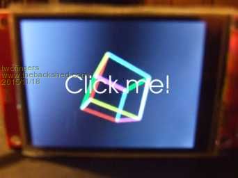

twofingers
Joined: 02/06/2014
Posts: 1773
Posted: 06:00am 18 Nov 2015
I use a BP170 and a chinese 2.4" ILI9341 display without any problems.
I can't imagine that Peters code can overstress this displays.
Maybe a different pin layout could help to catch the issue.
My pin layout (BP170):
OPTION LCDPANEL ILI9341, L, 4, 5, 6
OPTION TOUCH 7, 2
I used Peters code to make a MM Screensaver (assuming it's okay for Peter to post it here). This is a DEMO to show the versatility.
Michael
EDIT:
BTW. the framerate is ~8 FPS on a MX170/28 @48MHz.

@Phil
Peters original code has been running happily on my 100pin 470 / 2.4in TFT for about 4 hours now without problems.
Board is Snadpic with cheap Ebay display.

I clicked on the image above ( the "click me" graphic ) ..I expected a
small video like a youtube clip. But it sent a zip file instead,
I would guess with the quaternion basic source ( don't know as
I deleted it ). Was that the intent ?
(I'm not after quaternion code, just thought it would be a nifty video)
