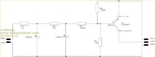

Posts: 11908
Posted: 06:34am 10 Nov 2015
  Quote  Please can you elaborate more i.e. can you provide circuit details/values
Standard transistor biasing. i.e. keeping the transistor in its linear operating range. Note the aggressive RC filter to smooth the slow pulse
This works on the breadboard. The circuit is inverting so 16 is dark and 0 is light
UPDATE What governs the size pictures appear on the BB? Mine always seem to end up small
Values are:
R1, R2 1K
R3 330R
R4 150R
R5 18K
Caps 100uF
PNP transistor 2N2907
Edited by matherp 2015-11-11
Posts: 2991
Posted: 07:11am 10 Nov 2015
Thanks Peter; just what I needed.
I will build it up and give it a go later . . .
WW

With the 3v3 RC circuit, I had to omit the 150R resistor as it caused the TFT to be dim at every setting. Without the 150R, the backlight was ok, but too dim for my needs (compared to 5v PWM backlight).

I guess this has highlighted that not all TFTs are 'equal' in terms of 'quality' (i.e. amount of flicker at different PWM frequencies, and also at differing viewing angles). I will run this setup for a few days to see how it holds out; so far it is behaving as I require.
Thanks for your methods posted here. From your explanation I guess 500Hz is not going to be achievable without a lot of work and/or a radical rethink. I am happy with the method I have resorted to apart from the fact it ties up one of the two PWM channels.
