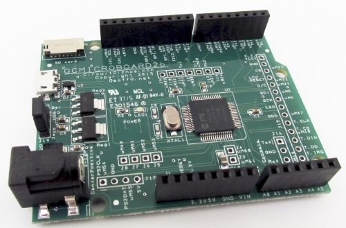

Maximites are different from Micromites.
You can update the CGCOLORMAX with the update software that Geoff has on his site. The CGCOLORMAX you have can be updated to Maximite formware version 4.5.
The CGMICROBOARD ( you can buy one here ) is a Micromite (not a Maximite) and the BASIC in a Micromite is more advanced.
