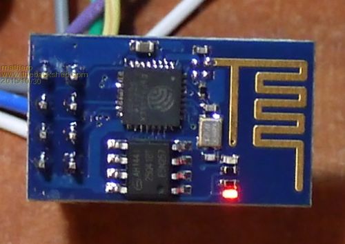

Thanks to viscomjim I've just wasted (spent profitably?) a day playing with the cheapest version of the ESP8266 modules - the ESP-01. There are lots of other variants but they all use the same underlying chip - ESP8266EX
First a warning: to run Basic it needs a 1Meg x 8-bit or bigger flash chip. This version only has a 512kb x 8-bit chip - easily replaced though.
However, it can run lots of other things.
To program it you need to download some suitable programmer software. Programming takes place over a normal USB/UART.
Google will uncover lots of information on programming but for the ESP-01. I connected as follows (viewed as in photo):
_________________________________________________________________________
| RX-pin on UART: GND |
| 10K to 3V3 : NC |
| 10K to 3v3 and switch to GND : 10K to GND |
| 3V3 : TX-pin on UART |
To program I found it best to hold the chip in reset with the switch to GND and then release it just before starting programming and it works perfectly everytime. Programming can be controlled using the DTR and RST pins on the USB UART but this relies on full function USB drivers and correctly implemented USB hardware so it is easier to do it manually.
The ESP8266 has a bootloader that can load programs and store them in the SPI flash memory which is included on all of the modules.

Posted: 10:15pm 31 Oct 2015
It took me a lot of failed attempts but I finally managed to program one of my 512k modules.
It is very interesting and shows a lot of promise.
Posts: 2998
Posted: 11:39pm 31 Oct 2015
  TassyJim said   It took me a lot of failed attempts but I finally managed to program one of my 512k modules.
If you don't mind me asking, what turned out to be causing the 'failed attempts'?
I am hoping to have a go at this later today but any 'advice' about potential 'traps' would be good to know about
WW
Posts: 12183
Posted: 03:32am 01 Nov 2015
  Quote  but any 'advice' about potential 'traps' would be good
If you follow the wiring in my original note it should work first time as follows:
select the options in the flash program (size and com port)
Then hold the ESP in reset and press "flash", immediately release the reset and all should work fine.
I found the key was to keep the ESP in reset until after the flash program is trying to write.
Posts: 2998
Posted: 05:10am 01 Nov 2015
Thanks Peter - was going to do as you posted (but into a 512k); however I was just curious as to TassyJim's issues.
Will let you know if I have any issues . . . .
Posted: 10:09am 01 Nov 2015
I didn't try holding the chip in reset until just before programming as Peter suggested.
I followed the 'brief' instructions at http://www.esp8266basic.com/flashing-instructions.html
I tried different USB-TTL adapters (ended up with an FTDI one).
The programming would fail to start usually but occasionally get part way through before spitting the dummy.

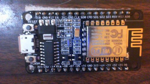

I think I am hooked. One of these for the HTML front end and a micromite hanging off the serial port for the serious maths and interface work.

The mod to increase memory on the ESP-01 didn't work. Despite specifically searching on RS for a SOIC part, the part I received was SOICW so didn't fit the pads. I tried to bodge it but it didn't work. Too many variables to know why. I replaced the 512K part and all works fine again.
The Basic for the ESP8266 continues to improve, I2C now working, but is PRIMITIVE in the extreme compared to MMBasic. However, the web access is very easy so probably worth persevering given the parts are so cheap.
This is very early days for the Basic development but the developer is extremely responsive both to additional functionality and bug fixes.
I bought a ESP-07 module to get more memory except it turned up with only 1M rather than the advertise 4M . It is however easier to breadboard than the ESP-01 and has more pins brought out. ESP-12 is probably the best way to go for a development environment.
Programming the new releases of the firmware continues to give no problems as long as GPIO0 is tied low and the device is held in reset until after the flash button is pushed.
