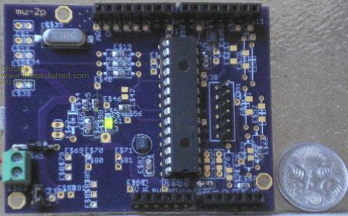

Ok here are the schematic and layout in pdfs.
2015-10-31_220024_schematicmu-2p.pdf
and
2015-10-31_220102_layoutmu-2px.pdf

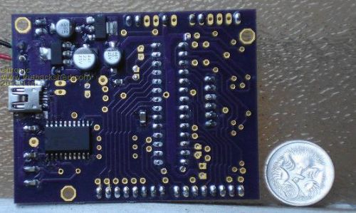

I have had prototype pcbs made by oshpark, who are excellent !! Beyootiful pcbs...
(ed)
The lurid photos.. I didn't bother about the silkscreen layer which has
come back to bite me, but as a prototype it's a bonza!! The coin is an
Aus 5 cents, about 2cm or 4/5 inch.
top
(flipped vertically)
Edited by chronic 2015-11-02
Posts: 2998
Posted: 11:26pm 31 Oct 2015
Nice looking boards there; nice to see them all built up!
I would have used ceramic caps instead of SMD electrolytics as I find the ceramics are cheaper, better spec, and smaller. The lower height off the ceramics may also make it easier to mount the PCB in an enclosure. NOT a criticism - just an observation
Do let us know how they perform for your application(s) . . . .
WW
isochronic
Joined: 21/01/2012
Posts: 689
Posted: 12:05pm 02 Nov 2015
I certainly agree, the power supply would be better with solid caps.. the higher value ceramics are expensive here in aus still though.
The boards are working well, either at 115k serial/usb with the interpreter or C, pickit3 and the ICSP pins etc. If someone wants to try micromite/MMBasic on it, send me details.

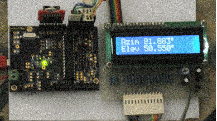

isochronic
Joined: 21/01/2012
Posts: 689
Posted: 02:47pm 17 Nov 2015
The board calculating solar position, using time from a ds3234 clock and preset
latitude / longitude, updating once a second.
Now to try to drive two mirror motors..should be straightforward. On
the other hand those 240x320 lcd's look so good...
(apologies for the photo quality, a bit fuzzy this morning!)
