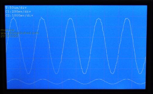

This is starter code for a 2 channel oscilloscope using a MM+ and a 800x480 SSD1963 display configured using the normal OPTION LCDPANEL command.
Starter code means that there is no GUI and of course to be properly useful the MM+ needs a programmable attenuator/gain stage building out of standard analogue hardware as a front end to the ADC.
However, the guts of the oscilloscope are fully worked in so far as it supports:
* 800x480 display divided into 10x8 divisions (the graticule lines are just visible in the picture)
* 2 channels at speeds up to 1.8 million samples per second per channel with 10-bit resolution
* continuous screen updates at a rate of 20 traces per second
* individual on/off channel switching
* programmable timebase specified in usec/division
* automatic display scaling if ADC cannot satisfy specified usec/division
* separately programmable amplitude for each channel in milli-volts per division
* free-running, or triggering off either one or both input channels with separately programmable positive or negative slope
* Trigger timeout that returns control to basic if no trigger occurs with 0.5 second

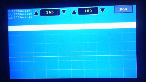

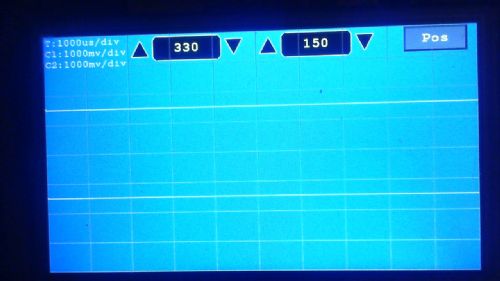

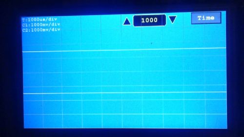

First Try - Scope GUI..
I know it's not much yet, but wanted to get some feedback...
The attached code is from the first Matherp post on the SSD1963 code.
I tried to keep the scope CFunction running all the time.
The two simple screens just adjust time and ch1, ch2 screen positions.
but, I ran into trouble trying to adjust the trace position in real time.
I seems that the Cfunction doesn't cleanup behind the position change...
Probably something I'm not doing right yet...
2015-10-29_023049_scope_gui_SSD1963.zip
Anyway, will keep at it, time permitting... (go bed now)...

Posts: 11890
Posted: 10:29pm 28 Oct 2015
  Quote  It seems that the Cfunction doesn't cleanup behind the position change...
Zonker, please see the thread on the single code version. I will only now keep this one updated. I've included additional functionality to deal with your problem.
