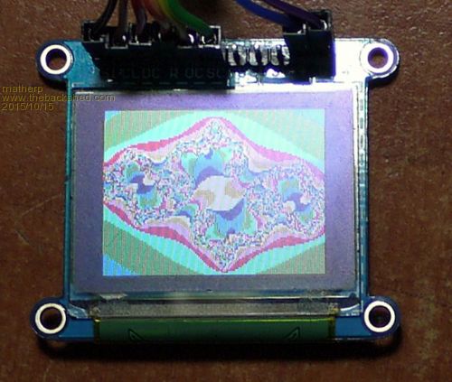

Another loadable driver, this time for the SSD1351 colour OLED. Seen here displaying Geoff's Julia. Support for this display was originally requested by WhiteWizzard
The picture doesn't do the display justice. The colour OLED gives a very bright and vibrant display. This version is again MX170 only. MX470 version by request.

sub mm.startup
dim myaddr%=peek(cfunaddr SSD1351plus)
SSD1351plus(myaddr%,3,2,1,96,1)'Address of CFunction, DCpin, RSTpin, CSpin, vertical resolution, orientation
end sub
' File SSD1351plus.bas written 16-Oct-2015 10:05:39
CSUB SSD1351plus

viscomjim
Joined: 08/01/2014
Posts: 925
Posted: 02:30am 16 Oct 2015
Excellent! Thank you Matherp for your hard work on these libraries.

  Quote  This version is again MX170 only. MX470 version by request.
So what needs to be done differently?
Posts: 12183
Posted: 05:52am 16 Oct 2015
  Quote  So what needs to be done differently?
Just configuration stuff. MX470 displays use SPI2, MX170 use SPI1. The pins on MX470 don't exist on MX170 (and in the case of the configurable pins, visa versa)
So it needs separate compilation and of course testing. Nothing difficult, just slog work

Posts: 2998
Posted: 04:29am 22 Feb 2016
@matherp
A quick couple of questions regarding your second post in this thread (i.e. the MX470 SSD1351 code you tested on your 64pinner)
Can I load this code into the Library so that it is 'invisible' to the end-user; and if so, does it then make all the MM+ firmware's 'graphic features' available to the end-user i.e. TEXT, BOX, CIRCLE . . . . .
I am ultimately after all the MMBASIC v5.1 built in TFT features, but on a physically smaller & brighter screen - so this OLED unit is perfect.
If all the above works as I am hoping it will do, will the GUI TEST LCDPANEL command work in the 'normal' way too?
Thanks,
WW
Posts: 12183
Posted: 06:07am 22 Feb 2016
  Quote  Can I load this code into the Library so that it is 'invisible' to the end-user; and if so, does it then make all the MM+ firmware's 'graphic features' available to the end-user i.e. TEXT, BOX, CIRCLE . . . . .
Yes
  Quote  If all the above works as I am hoping it will do, will the GUI TEST LCDPANEL command work in the 'normal' way too?
Yes
Just to bring this "older" driver in-line with current approach here is a very slightly amended version.
sub mm.startup
SSD1351plus(27,28,24,96,1)'DCpin, RSTpin, CSpin, vertical resolution, orientation
' Orientation: LANDSCAPE=1,PORTRAIT=2,RLANDSCAPE=3,RPORTRAIT=4
end sub

Posts: 12183
Posted: 07:01am 22 Feb 2016
  Quote  CLS rgb(white) causes the screen to clear to white, but with noticable flicker.
This is nothing to do with the Micromite or the driver code. Must be a function of the screen itself. Once the MM has loaded the pixels data into the screen it has no impact on the appearance.
You do seem sensitive to flicker, I remember you saw flicker in the PWM backlight when the rest of us didn't.
The OLED doesn't have a backlight as the OLED pixels generate the light themselves which is why it is so bright
  Quote  what has changed from your second post's code in this 'updated code'? Is it speed/features/other?
Other - you will see MMSTART no longer needs to calculate and pass the CFunction addressEdited by matherp 2016-02-23
