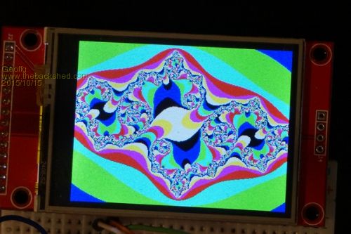

Julia set fractal on a 2.2" ILI9341 LCD:

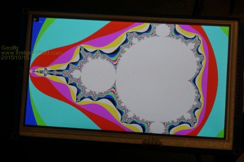

Mandelbrot set fractal on a 7" SSD1963 LCD:
The programs (modified to run on the Micromite or Micromite Plus) are listed below. Be warned, they can take a LONG time to finish:

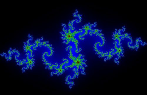

loki
Joined: 23/12/2011
Posts: 7
Posted: 06:41pm 18 Oct 2015
Thank you Geoff for your work on these. It gave me a warm and fuzzy feeling knowing others are having a bit of fun with fractals .
I've been offline the last few years due to my wife being very ill with breast cancer, and in fact she passed away 12 mths ago so I haven't had a lot of time for hobbies, but I'm slowly getting back in to it. I have one or two projects in mind for the maximite/micromite and if they succeed will share them on the backshed.
I'd like to take this oppurtunity to thank the backshed and all of the contributors to it, as it has helped me to avoid becoming depressed as I've followed the various discussions and projects and kept me interested in others, and what they're working on.
In the meantime I've been working on a Windows fractal program in C# that was until recently using the SetPixel() command to colour each pixel. I've been able to speed things up by writing the pre-prepared array of colour bytes directly to the bitmap memory location, then calling the Invalidate() method on the picture box control (that has the bitmap bound to it), which causes Windows to invalidate the entire surface of the control thus forcing it to be redrawn.
Don't know if this approach could be used on the mites or not. Is video memory directly accessible in any way, rather than use the PIXEL command? Is it possible to create a new api in mmbasic that would be analagous to microsoft's DirectX api?
thanks again

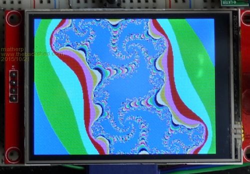

Posts: 12183
Posted: 01:00am 21 Oct 2015
This was drawn much much faster - 10 seconds
I've converted the JULIA code to a CSUB as an exercise.
This allows you to set the four parameters CRealVal, CImagVal, RealOffset, ImaginOffset in the call to the CSUB. Note that because of a limitation in CFunctions and CSUBs you have to call JULIA with variables rather than literals.
In the code I've included all the example parameters from loki's original post and the program steps through each one in turn taking about 10 seconds each on a ILI9341 driven by a MM+.
The code should work on any Micromite with any of the supported display types
I would like to increase the colour resolution by altering the way the RGB code is constructed in the DrawPixel statement but so far my attempts have failed - any suggestions appreciated.

A few more speed observations for the plain 'basic' version.
With my MM+ and 7inch display, the Julia set took 1979 seconds.
Change
CY = Y * YDelta + ImaginOffset
Zr = CX
Zi = CY
to
Zi = Y * YDelta + ImaginOffset
Zr = CX
and
new_Zr = Zr * Zr - Zi * Zi + CRealVal
new_Zi = 2 * Zr * Zi + CImagVal
Zr = new_Zr
Zi = new_Zi
to
Zr = new_Zr
By eliminating two lines of unnecessary assignments, the time reduced to 1791 seconds.
It makes the code less readable but with a significant speed improvement.
I am 20 minutes into another test run which is looking promising.
Posted: 06:02pm 21 Oct 2015
Last play. Changed the DO... LOOP to FOR... NEXT
FOR X = 0 TO (MM.HRES-1)
CX = X * Xdelta + RealOffset
FOR Y = 0 TO (MM.VRES-1)
Zr = CX
'Begin Iteration loop
FOR COUNT = 0 TO MAXIT
IF ( Zr * Zr + Zi * Zi ) >= 4 THEN EXIT FOR
Zr = new_Zr
NEXT COUNT
PIXEL X, Y, (COUNT AND 4) * 4177920 + (COUNT AND 2) * 32640 + (COUNT AND 1) * 255)
NEXT Y
NEXT X
Time down to 1616 seconds

On my MM+ with 320x240 ILI9341 screen, your last version takes 286 seconds.
By knocking the variable names off the NEXT statements, it drops to 277.5 seconds.
