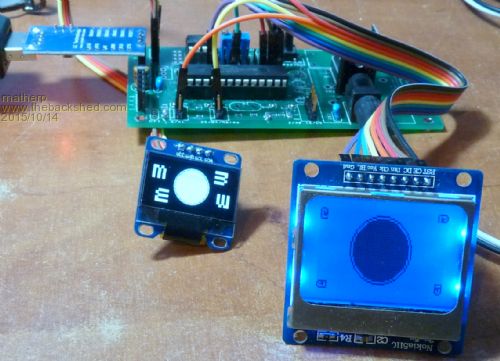

So given the above we can look at how to implement a driver for the SSD1306.
Colour displays use multiple bits of information to describe the colour of each pixel. However, in general monochrome displays use one bit per pixel and so typically a transfer of one byte of information to the display will update 8 pixels. This means if I want to change a single pixel I need to know the current value of the 7 other pixels which are linked in the same byte of input. I could do this by reading the display memory but in many cases of SPI displays they do not provide read capability so this is impossible. This means I need to keep a memory map of the current state of the display in my microprocessor memory.
In the case of the SSD1306 display it is 128 pixels wide and 64 pixels high so I need to maintain a memory map of 1024 bytes (128*64/8) to track the current state of the display.
The SSD1306 (in common with many monochrome display drivers) organises the display as 128*8 bytes so byte zero relates to pixels 0,0 0,1 0,2 0,3 0,4 0,5 0,6 0,7 i.e. a line 8-pixels long running down the screen starting at the top left hand corner (0,0).
It supports a mechanism for positioning the writing point (0-127,0-7) to define which set of 8 pixels will be updated.
To get the SSD1306 to display anything at all it needs some configuration data written to it. All display controllers need initialisation and they are all different. Google and the controller datasheet are your friend in sorting out the requirements for a specific controller. In the case of the SSD1306 it is quite straightforward particularly compared to some of the colour display controllers.
So to summarise this introduction:
We need to write three routines for the SSD1306: initialisation, drawrectangle, drawbitmap.
We need to handle the hardware mechanics of talking to the display (SPI)
We need to create and maintain some persistent memory to use as a memory map of the display.
In the next post we will look at the initialisation code. If you followed the previous tutorial most of the techniques used will be familiar.

Lets get started on the driver. First we need to set up some information at the top of the CFunction that will be used by the code

We tell the compiler that we want access to Microchips peripheral library "plib" and that we also want to access the Micromite internal routines as defined in "cfunctions.h".
Then we set up some "defines". These are simply string substitutions that can be used to make the code more readable. So when I use the value "screenwidth" the compiler will automatically substitute 128.
This version of the CFunction will only run on the MX170 but we need to know if it is running on a 44-pin chip or 28-pin one. This is needed because the pin numbers of the SPI pins are different on each.
HAS_44PINS is defined in cfunctions.h and reads the chips ID code to work out which chip is in use. This allows us to set SPI_INP_PIN etc. to the correct pin number for the part.
We then define the SPI registers that will be used by the code:
"define SPIBUF *(volatile unsigned int *)(0xbf805820)"
This says that when we use SPIBUF in our code we will actually be talking directly to memory location &HBF805820 which is the location in the PIC's memory map of the I/O buffer for SPI read/write. The "volatile" syntax is used to tell the compiler that the value may change without being changed in the code itself and therefore optimisations must be done without any assumptions of the value.
Finally we define the macro SPIsend. Again the string is just substituted by the compiler but in this case it is a block of code that writes to the SPI I/O register, waits for the write to complete, and then reads the buffer to clear it. This is our main way of outputting to the display.
Having set up these definitions we can start to look at the main program.

Next we are going to initialise the screen itself so a helper function is useful
void spi_write_command(unsigned char data){
PinSetBit(Option->LCD_CD, LATCLR);
PinSetBit(Option->LCD_CS, LATCLR);
SPIsend(data);
PinSetBit(Option->LCD_CS, LATSET);
spi_write_command sets the display to receive a command byte by setting CD low. It then sets chip-select low and outputs the command byte before returning chip-select high.
Using this we can then send the commands needed to initialise the screen

First we toggle the reset line to set things back to a defined state. Then we send a sequence of commands that are required by the SSD1306 controller. As stated above Google and the controller datasheet are the only ways of deriving the appropriate commands for any given controller.
