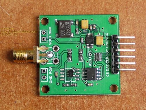

The AD9833 is a DDS function generator programmable by a SPI interface. The version I bought , pictured below, includes a MCP41010 8-bit digital potentiometer and an opamp to boost and control the amplitude of the output.
The attached Basic program shows how to control both the potentiometer and function generator to create Sine, Triangle, and Square waves of varying amplitude and frequency. It would be easy to combine this code with the GUI from this post to make a complete application.

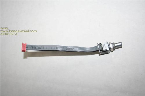

another choice is to use an optical encoder. I found this one (Grayhill with push button) on ebay for ~$10 new.

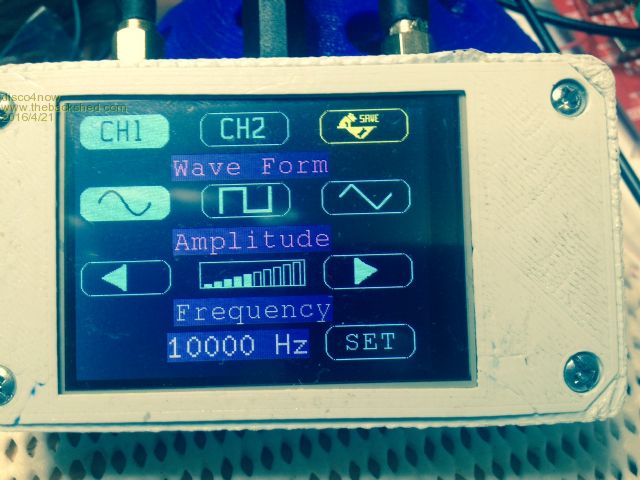

I ordered one of the AD9833 modules above sometime ago and started to write a GUI for it. I was removing the header pins to put it into a case when I made it not work by breaking some tracks.
So I ordered another one and then also managed to repair the first one.
So I updated the GUI to make a dual channel signal generator.
It looks like this.
The code for an MM2 with a 320*240 screen is below. It uses all Peter's code, gets a few ideas from Parking Assist and Boat computer, and I used FontTweak to make the graphic fonts. Thanks,Peter,Geoff and Jim.
I terminate the signal output in a 50ohm resistor as its supposed to be 50ohm output impedance.
The software works without any hardware attached so it can be run to get a feel for the interface with just the MM2.
2016-04-21_131530_SignalGeneratorAD9833_v1.0.bas.zip

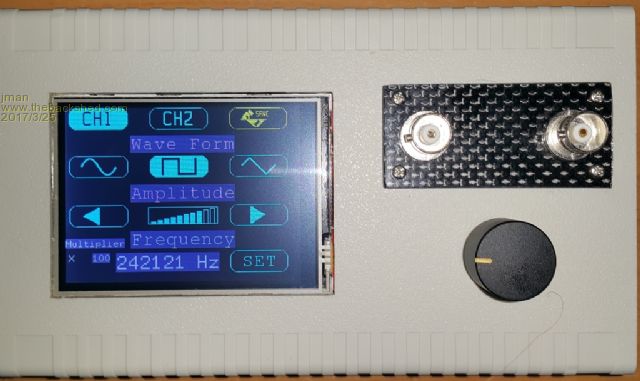

I had just finished my dual AD9833 Function generator before I saw the article in SC. So I thought I would share it.
My version uses Micks BackPack170 Micks BackPack170
I used the software posted by Disco4Now and added a rotary encoder and some code to use the encoder. The encoder has a built in switch so a quick press sets the multiplier from x1 to x10000 in 4 steps and longer press (+-2 seconds) updates the AD9833 with the new frequency.
Pic of the completed unit below
I will post the code if anybody is interested.

The rotary encoder is an Ebay special from here Rotary encoder
Any cheap rotary encoder will do I added .01uf caps from the encoder pins to ground and a .1uf to ground for the switch to assist with debounce
Program is attached with my modification's
Credit to disco4now for the original program
Jman

Even after I cleaned it with a CR + Schmitts, It does work but it is very "coarse" and sometimes it still can't tell which way it's being rotated (which is probably timing)...
I always intended to use some "inverse LOG" function or something like it to smooth out the increment based on the time... just never got round to it as I tend to "work-around" it for now.
we'll give this code a trip and see if it helps.Edited by CaptainBoing 2017-03-27
