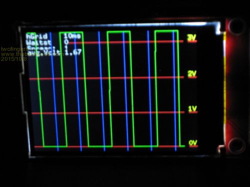

This picture shows the output for 50Hz/50% (~100 samples/cyle).
For this demo I conected the Input pin(23) with
output (PWM) pin(26). A voltage divider (1/10) seems a good idea.

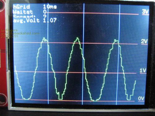

  chronic said   Any chance of connecting it to a 50 or 100 hz sin (eg plugpack) wave ?
Sure!
I connected two MM2's. The first with Peters function generator. The second with my "DSO" code (both MMBasic 4.7/b32). I can get about 5000s/sec in pure Basic.
This is an unfiltered sine wave (Spread=2).
And here comes a 100Hz triangel wave (Spread=1).

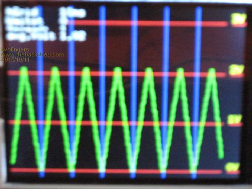

why?
Here are the original sample values for the first picture (50hz/50%PWM)
2015-10-11_152442_rect_samples.zip

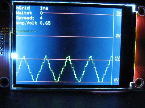

  chronic said   ..., which would mean about ten per 50hz waveform
Just out of curiosity. This shows a 500hz triangle wave to give an impression about 10s/cycles. Very bad.
EDIT2:

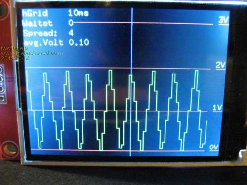

This picture - created by the newest MM.DSO version (incl. CFunction) and a voltage divider - shows a 5000Hz triangle wave signal (>80000s/sec).
WOW! Edited by twofingers 2015-10-14
