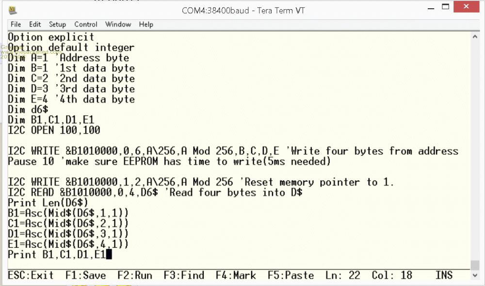

Try
I2C WRITE &B1010000,1,2,A\256,A Mod 256 'Reset memory pointer to 1.
as the write before the read.
In general when reading after sending an address the write should use option 1 to avoid sending a stop code

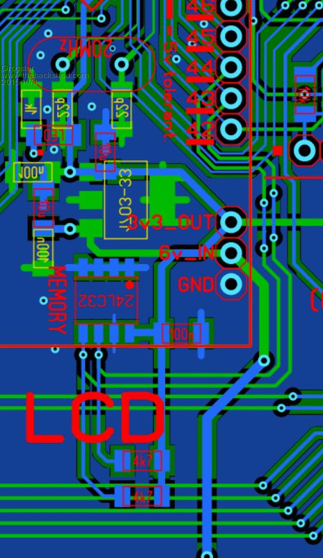

EEPROM is a Microchip 24LC32A SOIC on my own PCB.
It is not on a RTC module or other pre-assembled module from eBay.
WP(pin7) is grounded, so writing should be possible.
I'll post back tonight - stay tuned!

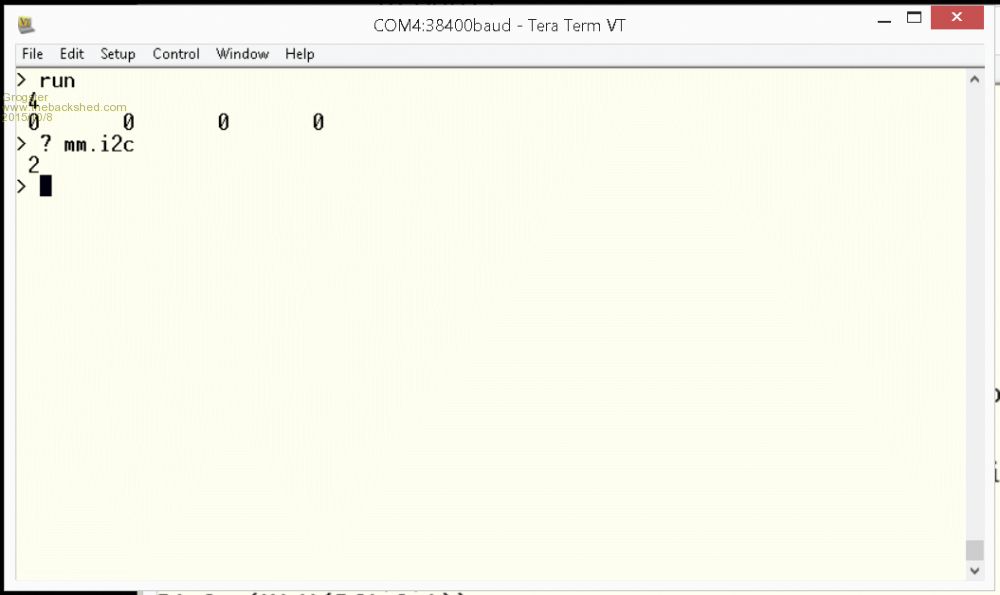

RESULTS:
4
0 0 0 0
? mm.i2c results in 2 - timeout.

Screenshots:

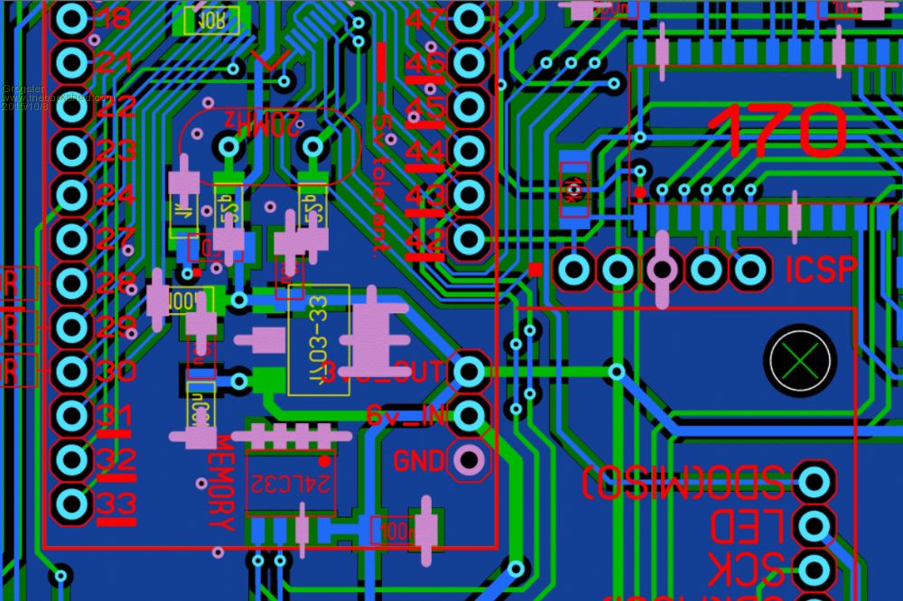

EDIT: Here is a shot of how I have the EEPROM connected to the MM+:

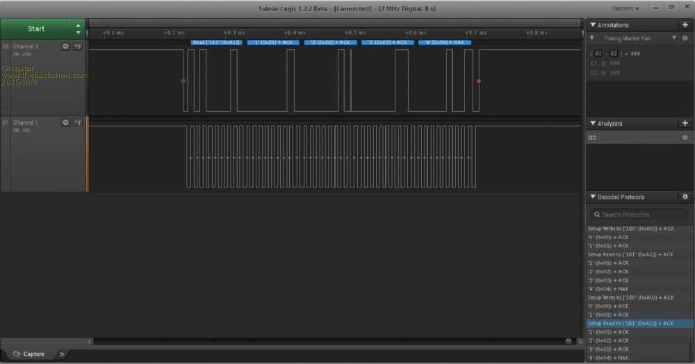

Next thing is to pull out the logic analyzer and see if we are getting things happening on the I2C pins - will post results of this test soon.

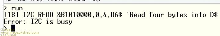

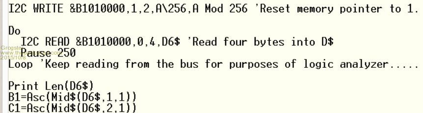

EDIT: Cannot run logic analyzer. Keep getting "I2C is busy" error messages. Even with pause 500's between writes or read attempts.
Is it possible there is a bug with the MM+ I2C?
I will now try the same code on a 170 and see what happens.
EDIT: Have got rid of the "I2C is busy" error - removed the logic analyzer - it's wires must have been holding the bus till you start sampling. Will start running then connect analyzer.

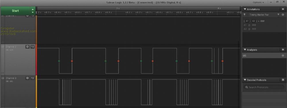

Posts: 10109
Posted: 08:50pm 07 Oct 2015

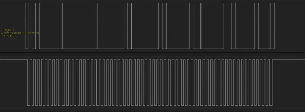

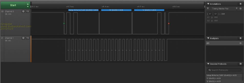

RESULTS:
Results from the logic analyser:
EDIT: Analyser results are from my previous attempts, not jman's test code.
I have yet to try any of this code on a 170, but that is next. I will cut the SCL and SDA tracks to the MM+ chip, and hop onto these from a 170.Edited by Grogster 2015-10-09

Is WP tied low? This has to be connected and must be low to allow writes.
A0,A1, A2, VSS are all obviously connected but do they also connect to GND? Difficult to tell from the pic.
Do you still design boards without a schematic? It really really makes things easier if you start from the schematic and then the design check in the PCB software can make sure the layout is correct.
Posts: 10109
Posted: 08:56pm 07 Oct 2015
@ matherp - yes WP grounded - see post #4.
According to the test-tool in the layout software, all points that should be ground, are ground:
I do have a couple of those RTC/EEPROM eBay modules, so I might hook one of them up to a spare MM+ and see if I have the same issue.

What pins are you using?
I use I2C (1) pins 43 and 44.
Edit: I just traced your board. The pins look correct so I think the beta32 will fix it.
Edited by TassyJim 2015-10-09
Posts: 10109
Posted: 09:05pm 07 Oct 2015
Yes, pins 43 and 44 - see images above.
This is what I can't understand - it should be working, but isn't - I hate these sorts of feckin' issues.
I will check for continuity on the SCL and SDA tracks - perhaps we have a fluffy via on the PCB or something. I will also check that ALL pins 1-4 and 7 are indeed grounded.

...I have a working theory - stay tuned for an update...(board is slightly different to the version in the images - no feckin' pull-ups on SDA or SCL at all, despite what I insisted was the case in post #1.
...please don't kill me, if this ends up being the problem, and it probably is, as those pull-ups are essential........
Will fit some now, and get back ASAFP.

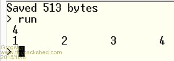

For now, I just changed the code, and guess what? (rhetorical)
And with my ORIGINAL feckin' code:
Schoolboy mistake, and I should have known better.....
My sincerest apologies for wasting everyone's time - sheesh......
EDIT: ....and the analyser output looks much healtier too now....
