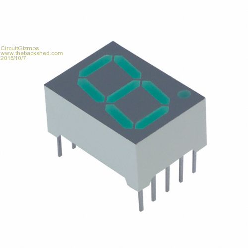

You could straddle a 7-segment LED display over a DS2408 or over a pcf8574.
