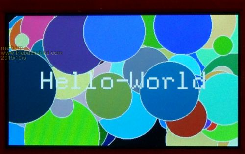

In a thread ages ago someone asked if it was possible to display text without the character background overwriting the existing display - it is now
This builds on the sprite code and uses the same technique of reading the SSD1963 display memory and then writing it back with only the text pixels updated and the background pixels left as-is.
In this case the read of the display is built into the loadable driver code and is triggered by setting the background colour to the value 1. This is chosen as a non-useful colour i.e. a blue so dark it is completely indistinguishable from black.
To use this facility it is necessary to connect the RD pin on the display to the Micromite. The loadable driver will then automatically set this as an output. If the RD pin allocation is omitted in the call to display.open then the driver will work as before and a backgound colour of 1 will be a very dark blue.
At the moment the code will only run on a 44-pin Micromite uM2 using the special loadable SSD1963 driver included in the example code and it needs the pinout set as below:
you must use pins 25,26,27,36,37,38,2,3 for the data pins DB0-DB7
you must use pin 4 for RS and pin 5 for WR
Tie CS Low
connect RD to an unused Micromite output and set the pin number in MM.STARTUP
connect RST to an unused Micromite output and set the pin number in MM.STARTUP
Note that I am using a PWM output to control the display backlight - this is specific to my test system and you probably won't need it.
I will write a version for the MM+ once I have a suitable test system available.
There is one "feature" related to the way Geoff has implemented the space character as a rectangle in the backgound colour rather than as an actual character - unfortunately a space will always overwrite the display in the background colour. The workround is to output multiple strings rather than a single string with spaces.
Also note that the CFunction allocates temporary memory to store the existing display pixels. If you are using a very large scaled font or your program is using most of the Micromite RAM you may see an "out of memory error" when using the overlayed font mode.
My test program is:

' Demonstration of using overlayed text
' To specify that text should be overlayed set the background colour to 1
dim integer t,x,y,r,c
colour rgb(white),1 'background colour set to 1 to use overlay mode
PWM 1,1000,50 ' turn on the backlight control
cls
if (MM.HRes > MM.VRes) then : t=MM.HRes \7 : else : t=MM.VRES\7: endif
do while(1) 'fill the screen with random circles
x=cint(rnd() * mm.HRes)
y=cint(rnd() * mm.VRes)
r=cint(rnd() * t + t\5)
c=rgb(cint(rnd() *255), cint(rnd() * 255), cint(rnd() * 255))
Circle x,y,r,,,&HFFFFFF,c
text mm.hres\2,mm.vres\2,"Hello-World",CM,,4
loop
end

Please find attached an alternative driver for the SSD1963 to run on the 64-pin MM+ that supports overlay text as per the picture above.
Make sure there is no LCD panel already enabled with the option command. Use OPTION LCDPANEL DISABLE if required. Then load the program (save it in the library if you want). Reboot the MM+ and the new driver will be enabled.
It uses the normal MM+ SSD1963 pins + the ability to specify a connection to the RD pin on the display.
Using the RD pin allows the program to read the display's video memory and therefore write bitmaps (including text) without overwriting the existing background.
To do this, as detailed above, just specify the background colour as "1" e.g.
text 0,0,"hello",,,5,rgb(blue),1
The colour "1" is used as a code to cause the Cfunction to read in the display memory and only overwrite pixels that require the foreground colour of the text.
sub mm.startup
SSD1963(PEEK(CFUNADDR SSD1963),30,1,5 ) ' Address, RD pin, orientation, size
end sub

}else{
DrawBitmapVectorOffset=*MyAddress + ((unsigned int)&DrawBitmap_SSD1963 - (unsigned int)&main);
//Save DisplayMetrics
if(Option->LCD_CD<5){
HorizontalRes=480;
VerticalRes=272;
} else {
HorizontalRes=800;
VerticalRes=480;
//Reset the SSD1963
PinSetBit(Option->LCD_Reset,LATSET);
uSec(10000);
PinSetBit(Option->LCD_Reset,LATCLR);
uSec(10000);
uSec(10000);
if(Option->LCD_CD<5) {
write_command_data(0xE2,3,0x23,0x02,0x54);
} else {
if(Option->LCD_CD<6){
write_command_data(0xE2,3,0x1E,0x02,0x54);
} else {
write_command_data(0xE2,3,0x23,0x02,0x04);
write_command_data(0xE0,1,0x01); uSec( 10000); // PLL enable
write_command_data(0xE0,1,0x03); uSec( 10000);
write_command_data(0x01,0); uSec( 100000); // software reset
write_command_data(0xE6,3,0x01,0x1F,0xFF);
write_command_data(0xB0,7,0x20,0x00,0x01,0xDF,0x01,0x0F,0x00); //LCD SPECIFICATION
write_command_data(0xB4,8,0x02,0x13,0x00,0x08,0x2B,0x00,0x02,0x00);
write_command_data(0xB6,7,0x01,0x20,0x00,0x04,0x0C,0x00,0x02);
} else {
if (Option->LCD_CD<6){
write_command_data(0xE6,3,0x03,0xFF,0xFF);
write_command_data(0xB0,7,0x24,0x00,0x03,0x1F,0x01,0xDF,0x00); //LCD SPECIFICATION
} else {
write_command_data(0xE6,3,0x04,0x93,0xE0);
write_command_data(0xB0,7,0x00,0x00,0x03,0x1F,0x01,0xDF,0x00); //LCD SPECIFICATION
write_command_data(0xB4,8,0x03,0xA0,0x00,0x2E,0x30,0x00,0x0F,0x00);
write_command_data(0xB6,7,0x02,0x0D,0x00,0x10,0x10,0x00,0x08);
write_command_data(0xBA,1,0x0F);
write_command_data(0xB8,2,0x07,0x01);
write_command_data(0x36,1,0x00); //rotation
write_command_data(0xF0,1,0x00); //PIXEL data interface - 8-bit
write_command_data(0x3A,1,0b01110000); //PIXEL data interface 24-bit
write_command_data(0x26,1,0x01); uSec( 10000); //gamma curve
write_command_data(0x29,0); //display on
write_command_data(0xBE,6,0x06,0xF0,0x01,0xF0,0x00,0x00); //set PWM for B/L
write_command_data(0xd0,1,0x0D);
//Set Hres and VRes
if(Option->DISPLAY_ORIENTATION==PORTRAIT){
if (Option->LCD_CD<6) t=0xA0;
else t=0xE0;
if(Option->DISPLAY_ORIENTATION==RPORTRAIT){
if (Option->LCD_CD<6) t=0x60;
else t=0x20;
if(Option->DISPLAY_ORIENTATION==LANDSCAPE){
if (Option->LCD_CD<6) t=0x00;
else t=0x40;
if(Option->DISPLAY_ORIENTATION==RLANDSCAPE){
if (Option->LCD_CD<6) t=0xC0;
else t=0x80;
write_command_data(0x36,1,t);
if(Option->DISPLAY_ORIENTATION&1){
HRes=HorizontalRes;
VRes=VerticalRes;
} else {
VRes=HorizontalRes;
HRes=VerticalRes;
//Set the DrawRectangle vector to point to our function
DrawRectangleVector=DrawRectangleVectorOffset;
//Set the DrawBitmap vector to point to our function
DrawBitmapVector=DrawBitmapVectorOffset;
//CLS
DrawRectangle(0,0,HRes-1,VRes-1,0x000000);
return 0;
