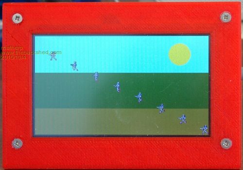

I've then written a CFunction that allows one or more sprites to be displayed on a SSD1963 screen. Of course a "sprite" need not be a complex graphic but could equally be a text character. The code would then allow text to be superimposed on a pre-defined background rather than overwriting it.
There is one callable CFunction SPRITE. This takes the following parameters:
Mode: can be clearsprite=0, writesprite=1, movesprite=2
RDpin: The number of the pin connected to the RD input of the display, needed to read the display memory
X%: x-coordinate of the top left of the sprite to be written or displayed
Y%: y-coordinate of the top left of the sprite to be written or displayed
width%: width of the sprite in pixels
height%: height of the sprite in pixels
displaybuff: an array used to hold the contents of the display memory before displaying the sprite
OPTIONAL spritebuff: an array holding the pixel information for the sprite, not needed for the clear mode
OPTIONAL NewX: x-coordinate of the top left of the new position of a sprite to be moved, in this case X% holds the original position
OPTIONAL NewY: y-coordinate of the top left of the new position of a sprite to be moved, in this case X% holds the original position
The way the sprite write-mode processing works is to:
Save the existing display contents in the area defined by x,y,width,height
Write out the sprite but overwrite only those pixels which are non-zero in the Sprite
Move mode works by:
Restoring the display content in the area where the sprite was originally located
Saving the display contents in the area where the sprite will now be located
Move mode is the same as doing a "clear" followed by a "write", but because it is done as a single CFunction call it is much quicker. Note in the video there is a 40msec wait between each "step" so the update capability is much faster than shown.

Peter, can I ask how or where you obtained the enclosure for the screen?
GM
Posts: 12183
Posted: 08:49pm 05 Oct 2015
  Quote  can I ask how or where you obtained the enclosure for the screen?
It is 3D printed. I'm away from home at the moment but can post the .STL file when I get home

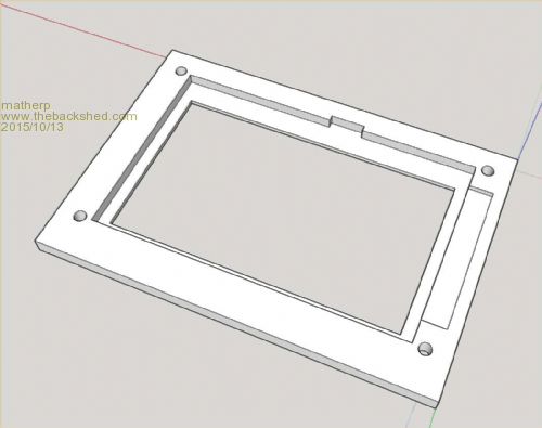

Posts: 12183
Posted: 03:33am 13 Oct 2015
3D model attached as promised. Note the cutouts for the header pins and the touch screen cable
and model file:
2015-10-13_133222_mountforscreen.zip
