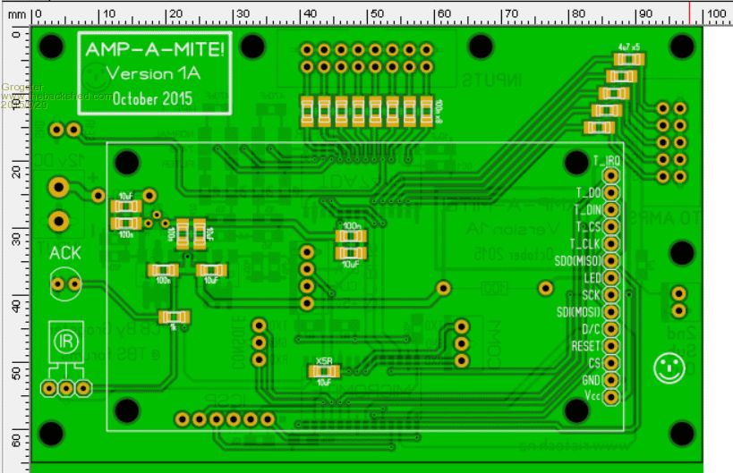

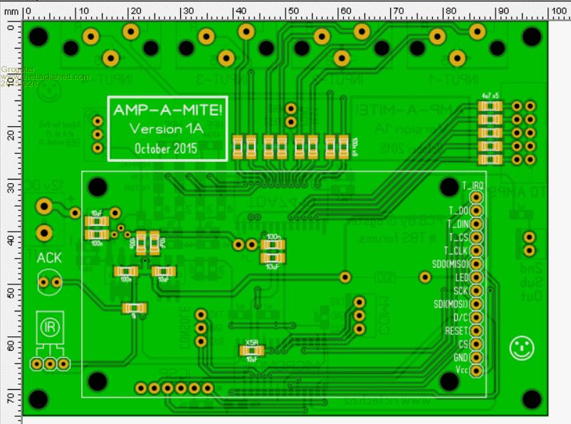

Initial PCB done. There are still some tweaks to do. It is 100x75.
TOP(LCD side):
BOTTOM:
I have never used the 7419 before, so I just copied the datasheet test circuit for the 1A board, so I can tinker. Inputs 1-4 are via dual-RCA sockets mounted on the board.
As everything to do with the audio side of things is done through I2C commands, I should be able to test out everything using test loops in the MM for a start, then once I get the hang of everything, I can write some proper code incorporating the LCD.

Posts: 10109
Posted: 09:01pm 28 Sep 2015

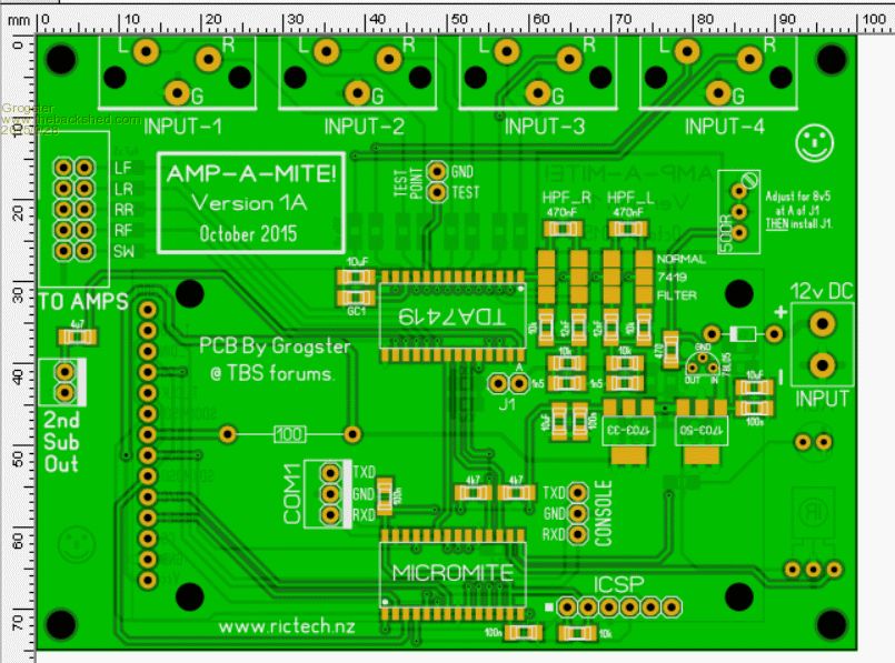

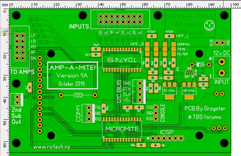

UPDATE
Board is 10mm smaller now - 100x65, so will definitely fit in a 2U case now, and the audio inputs are now on a IDC cable same as the audio outputs.
For line-level signals, IDC is fine, and in fact, if you look inside many a commercial amplifier, this is exactly how they couple their audio from board to board - via FPC cable or other flat multi-core.
...you can't do this with low-voltage inputs(Phono/Record-player cartridge or dynamic microphone), but this unit does not allow for that anyway...
The same 100x100 panel will now contain a 2nd board, which will be the input panel.
The input panel is linked to the main preamp board with 16-way IDC cable and plugs.
The signals are laid out as signal/ground/signal/ground, to minimize any crosstalk and to also allow nice easy connection by either IDC cables, or even just plain old jumper wires if need be.
The I2C bus and 5v supply are now also on a header, as I have plans for a 3rd board specific to my needs, which will be another MM controlled speaker A/B switching arrangement plus speaker de-thump relays.
TOP:
BOTTOM:
...the tinkering continues...

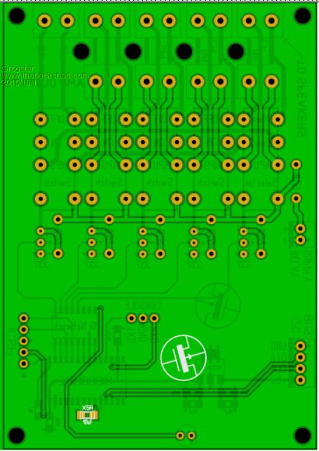

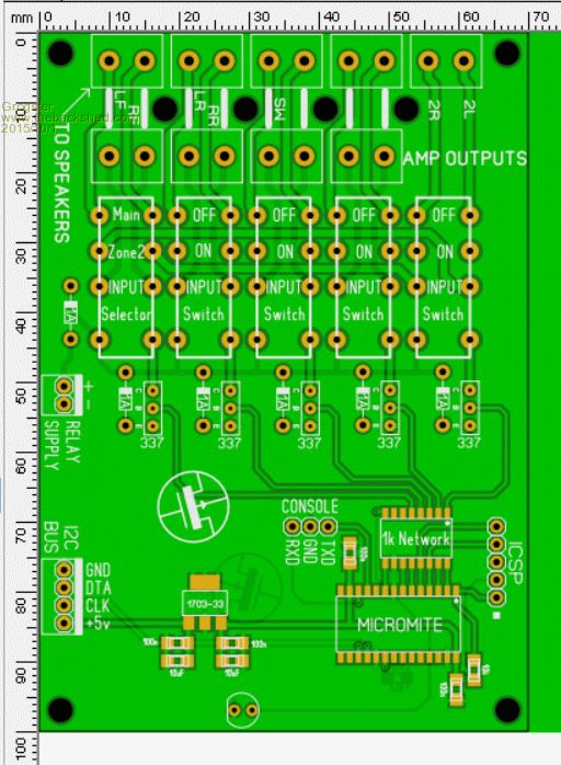

I have designed a speaker relay board, also controlled by a MM. This board serves a couple of functions: (1) speaker de-thump relays as all speakers are off by default, and (2) speaker switching and zone selector. All of these relays can be turned off and on via the main pre-amp's MM I2C Master and the GUI SWITCH controls, which allows for full control of which speaker sets you want on or off. At power-up, this board will enable all four speakers, the sub and select zone1 for the front speakers.
This board gets its power and I2C control from the main pre-amp board. The relays have their own supply line, as I have not decided on 5v or 12v relays yet - probably 12v ones as this will take the relay coil load off the 5v regulators. There are no pull-ups on the I2C bus on this board, as they are on the pre-amp board.
