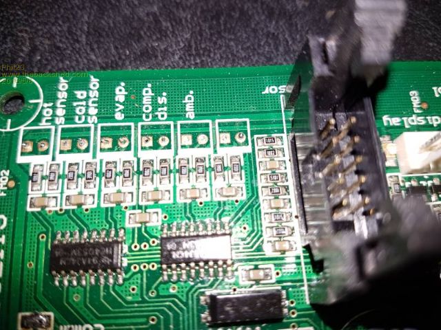

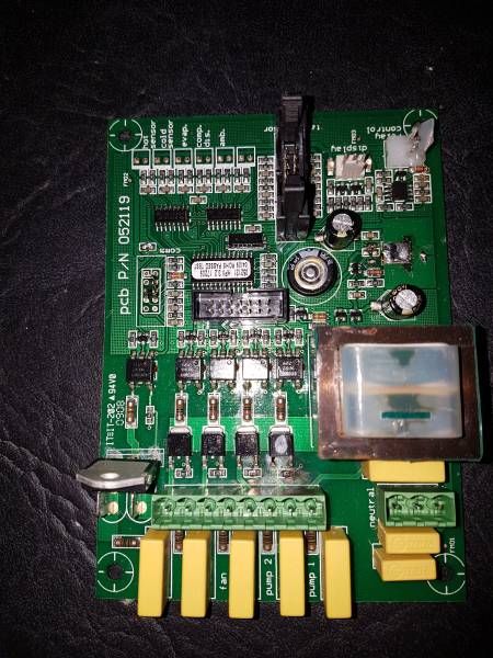

I'm in the process of building a replacement controller board for a heat pump unit I'm converting to a Hot Tub heater.
Original board is fried, but would also not work outside it's native environment, of the tank & associated sensors.
It accepted 5 thermistors from the heat exchange unit & another 4 from the water tank.
I just plan to use the 5 on the HP, primarily for protection of the unit.

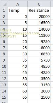

Have found a service sheet with resistance/temp test readings & also done my own readings from 0°C to 65°C. The devices appear to be Nominal 8k @ 25°C.
Both sets give different Steinhart Coefficients & Beta values, but my own seem a better fit.
What I'm looking for advice on is what is the best value series resistor to use with the Micromites analogue inputs.
Trying 8.2k currently, but it appears the original circuit board used 10k's.
The Thermistors monitor ambient, water in & out of heat exchanger, compressor & evaporator, with normal ranges of locations ranging from around 10° up to about 60°C.
Compressor them is probably a crucial one, as on a couple of occasions I've had the compressor go into rotor lockup when water flow is lost & pressures rise.
External temp of the unit climbing from mid 60's into the 90's.
Not a good situation & would rather be catching it well before it happens.
Any opinions on resistance values? Stay with nominal or a bit lower or higher.

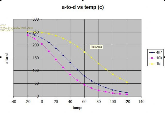

Choose the same resistance as that of the thermistor at the middle of the range of the temperatures you are trying to measure. This maximises the worst-case temperature resolution. I have attached a graph from an excel spreadsheet that I made to help visualise the situation.
e.g. if you want to measure from 20c to 40c, calculate your thermistor resistance at (20+40)/2 ie 30c. Use approximately this resistance to analog Vdd to bias the thermistor.

Values I measured & the quoted values were:-
So I'm probably better off going with 8k or lower even, as opposed to the 10k the original control board used.
Or I could mix values & deal with in in software, but could be a bit of a pain.
