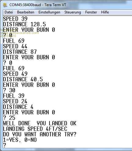

I have already two versions for the Maximite.
Maybe I'll convert your code in a more modern style?
My first try:
Michael

twofingers
Joined: 02/06/2014
Posts: 1773
Posted: 01:38am 20 Sep 2015
  Chris Roper said   Thanks, that is the only piece of code I haven't tested as I haven't landed it yet
The "trick" is to do nothing till you're halfway down.
(0,0,5,13,20,13,0,0,0,0,30,25)
  Chris Roper said  I could probably have even left the Line numbers too
of course!
The lone and ...
