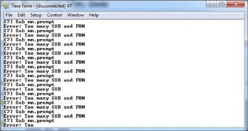

This is a weird one:
I did an XModem transfer of this code:
[code]
Const ds4 = 4
Const ds3 = 5
Const ds2 = 6
Const ds1 = 7
Const sw1 = 16
Const rp1 = 26
sub mm.prompt
setpin ds4, dout
setpin ds3, dout
setpin ds2, dout
setpin ds1, dout
setpin sw1, din
setpin rp1, ain
Print "LPCDB>"
end sub
[/code]
and the Micromite (28pin) went into an unbreakable loop with the following Console Output:

Posted: 12:05pm 20 Sep 2015
Chris
I think the important part is the error message I got at the beginning of the output:
sub mm.prompt
setpin 4, dout
setpin 5, dout
setpin 6, dout
setpin 7, dout
setpin 16, din
setpin 26, ain
Print "LPCDB>"
end sub
Saved 313 bytes
[11] SetPin 4, dout
Error: Pin 4 is reserved on startup
[11] SetPin 4, dout
[11] SetPin 4, dout
I am using pin 4 for the LCD so the error message is valid, just no way of fixing it.
Eventually the message changed to too many SUBs the same as Chris.
I was unable to reset the MM+ and had to bring out the programmer....
I think that if there is an error in MM.PROMPT, we should be put back to the normal prompt without trying to run the sub again.

Posts: 3372
Posted: 03:36pm 20 Sep 2015
Yes, now that I am concentrating on the MX470 (Micromite Plus) I plan to do the 100-pin version as well as some important bugs (eg, USB and Win 10).
This beta has a couple of issues with MM.PROMPT - First, it is not consistently recognised after EDIT, XMODEM, etc. The second is that an error inside the sub causes mayhem. I will fix both of these in the next release.

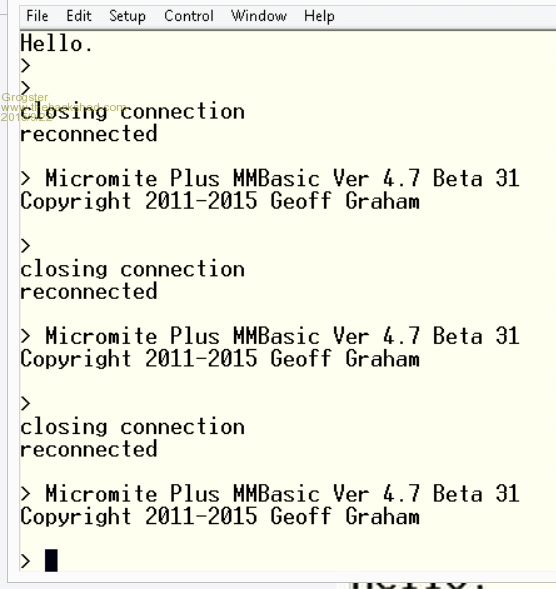

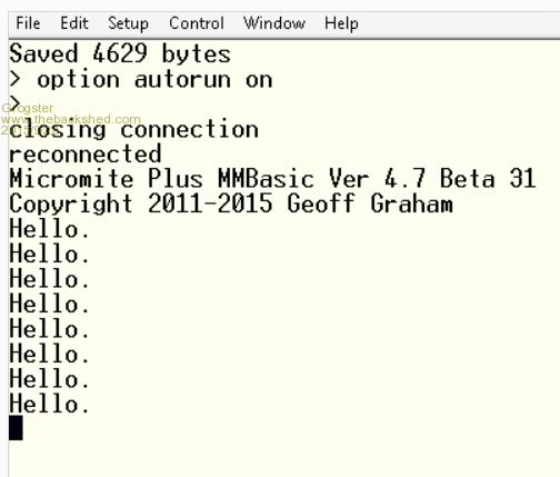

Posts: 10109
Posted: 11:57pm 21 Sep 2015
Sounds like you are getting parasitic power from the serial connection, and once you remove that connection, that source of parasitic power is then gone, so the chip does not start, or has a dirty start because there is no 'Clean' power. Parasitic power can supply enough power to run the chip, if that is where the supply is coming from, so you need to look carefully at the way you are powering the chip.
What exactly are you using to power the circuit?
Are you using a pre-built module or your own chip circuit on a breadboard?
Breadboards have been the source of many problems before today......
EDIT: Seems OK on my module - I just setup a "Hello" loop, and then reset the MM+, and away it went as it was supposed to:
Edited by Grogster 2015-09-23
