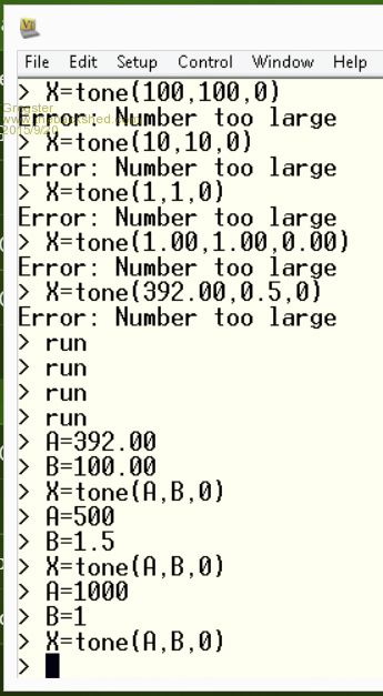

EDIT: How do you issue just simple notes to the Cfunction WITHOUT all the constants and DIM's etc - I need to just be able to issue a single line of code, and have the Cfunction play that note, then return. I have tried several variations of the syntax to the Cfunction, but MMBASIC just moans that "Number too large." - even with numbers as low as 1 or 1.00.
Little prod?Edited by Grogster 2015-09-21

Ditto what Grogs is asking . . . How to drive the 'sound pin' with a simple one-liner.

  Quote  How to drive the 'sound pin' with a simple one-liner
If you had been reading the CFunction tutorials carefully you would know the answer
You can't use float literals with CFunctions so:
i%=tone(261.6,0.5,sinewave%()) won't work
a!=261.6
b!=0.5
i%=tone(a!,b!,sinewave%()) should work fine
Of course you need to have run something first to load up sinewave%()

I don't get what the call to 'sinewave%' is all about. You have note in a!, you have duration in b!. There is an array with data in sinewave, but then you call it in the Cfunction with no reference to any point in the array - '()' - I don't follow that.
I have been reading through the other Cfunction thread, but I am having trouble following it. I will keep reading it, but C code confuses the hell out of me. I guess it is simply cos I don't understand any of the C language syntax, so it just looks like gobble-de-gook to me. However, given some time, I am sure I could pick it up, but I don't have enough of the aformentioned time.
Posts: 10114
Posted: 09:49pm 19 Sep 2015
Owwwww - I am getting a result now.....
I am just using zero for the 'Sinewave%' reference, and it is giving me tones, which is what I want.

Posted: 09:58pm 19 Sep 2015
  Quote  I am just using zero for the 'Sinewave%' reference, and it is giving me tones, which is what I want.
You don't need anything in between the brackets. This is just the same as passing an array to a Basic function - see the example of passing arrays in the MMBasic manual.
The syntax "sinewave%()" just says pass the complete array. "sinewave%(0)" happens to work because the address of "sinewave(0)" is the same as the address of the start of the array but is not really correct and wouldn't work in Basic

Hi Matherp, I was hoping to use this Tone cfunction but I have been unable to make it work satisfactorily. I was planning to use a Piezo speaker but there is minimal drive out of the port. When I look with the scope although it is working the output is not driving to ground it is only riding on the very top of the dc level at 3.3v, it is only varying by maybe 50mv. Now what I have noticed is that if I set up the pin 25 (I am using a 28 pin MM2) as an output and run a short program that creates a square wave the wave form is perfect full waveform however after running the Tone Cfunction, your test program , If I go back and load my pin 25 test squarewave again, it also only produces a very small wave form on the top dc level. This will remain this way until you power cycle the chip. I have tried another chip and different versions b31 37 and ver 5.00, all behave the same. Any ideas.
Codenquilts
Posted: 12:44am 11 Dec 2015
The output of CVREF is very high impedance. To test the program put a 100K resistor between pin 25 and GND and have a look on the scope (x10 probe). If this works then the piezo speaker is loading the pin too much. I've only tried it using an amp and haven't tried a 28-pin chip but it works on 44-pin and 64-pin so there is no reason 28 won't. Don't use any sort of SETPIN command in your program - the CFunction does this for you
The program leaves the pin as a CVREF output overriding SETPIN so that is why your square wave acts the same after running - reboot to fix this
Posts: 10114
Posted: 02:36am 11 Dec 2015
I have used this Cfunction a couple of times since matherp released it, and I can say it works great. I expect you are loading the pin too much, as Peter says.
In my case, I used a 10k resistor in series with the pin, and a 100n DC blocking cap before coupling that to an audio amplifier, and the tones are perfect. I have tried the Cfunction on a 28-pin device, and it works fine.
Just for the purposes of experimentation, have you tried coupling the CVREF output to an amp and little speaker? I would be suggesting you try that next to prove you are getting an output.
