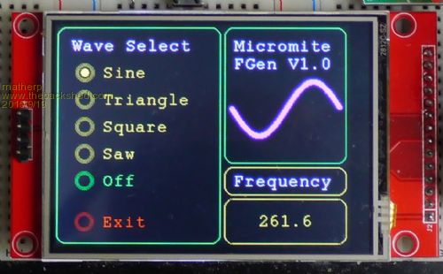

While developing the tutorial on CFunctions I played with the CVREF voltage hardware in the PIC32, something new for me. By configuring this you can get a 4-bit DAC output on pin-23 of the 64-bit MM+ (pin-29 on the 100 pin part, pin 25 of a 28-pin MX170 and pin 14 of a 44-pin part). In the tutorial thread we developed a very simple demo of the CFunction. This was only intended to help in the tutorial but the functionality that could be achieved was surprisingly good.
In this "full" version I have added a GUI using the touch screen on the ILI9341 display running on a MM+. It allows a range of waveforms to be created between 1 and 50,000Hz. The user interface would need reworking on a uM2 to replace the GUI commands but the cFunction will work as is.
The CFunction was written to run until it receives a ground input on a specified I/O pin. I've changed this and used the new facilities in 4.7 to tell it to look at the T_IRQ pin.
"while(PinRead(Option->TOUCH_IRQ))"
So when the touch input is used it automatically returns control to Basic which can then process the GUI commands. Much to my surprise this works beautifully and is a very simple protocol that can be used for many applications.
The GUI allows selection between sine, triangle, square, and saw tooth waves. I have also modified the CFunction to accept the frequency as a floating point number. This allows the exact frequencies such as middle-C (261.6 Hz) to be input.

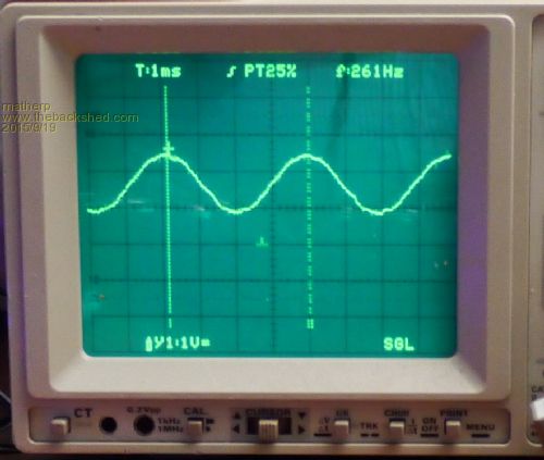

Of course a 4-bit DAC gives a fairly rough waveform but with judicious use of an RC-filter it can be smoothed to give a quite good output.
10Kohm/1nF works nicely at 1000Hz
10Kohm/220pf works at 5000HZ
In the picture I've used 10K/4.7nF with a 261.6 HZ Middle-C output
If you really wanted to be clever you could connect the ground end of a range of capacitors to various PIC pins and select the filtering based on the frequency chosen by switching pins between high impedance (inputs) or low outputs.
Just one point about the output from CVREF (DAC). It is very high impedance so I use a BUF634 after the filter to create a 50ohm output.
The BUF634 is a great device if a little pricey. It is a unity gain opamp with up to 250ma drive capability in a 5-pin TO220 style package. Only 4 pins need to be used, VCC, GND, Vin, Vout, and it works happily on a single 5V supply. It even survives a continuous short-circuited output. Of course any unity-gain stable, single supply, opamp with near rail-rail output could be used.

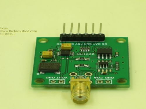

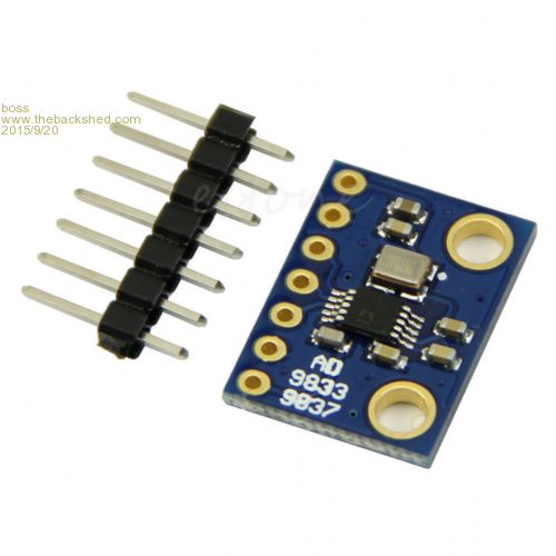

And if you add one of these AD9833 modules you get the signal generator covers band from less then 1Hz to 12.5 MHz (with simple low pass filter or ~6MHz w/o filter.
The module price is ~$6 for basic not -amplified module while amplified version is around $10. Together with graphic display you have a nice equipment for less than $30.
