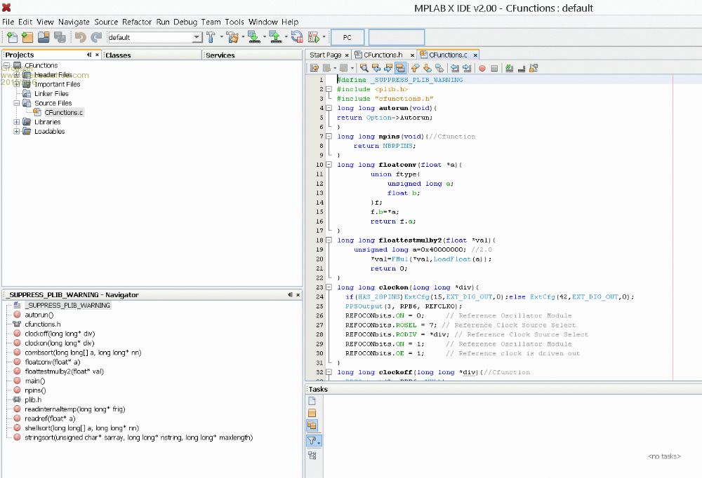

Run MPLabX. From the file menu select "Open Project". Browse to the directory containing the extracted sample "CFunction.X" and click "Open Project"
This should open various windows, on the left hand side is the project browser, the main panel is the source code for the sample.
Click on the hammer icon with the brush and the output window will display build progress and hopefully a message saying "Build Successful"

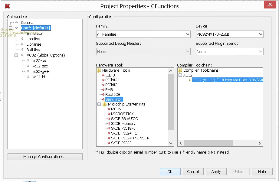

Open the example project and in the "projects" tab, right click on CFunctions. Select the last option "properties"
Note that in the Compiler toolchain window you should see XC32 (V1.33) highlighted. If it isn't select it. (Grogster )
Then click on "xc32-gcc" under "XC32(Global Options)" in the additional options you will see the text:
"-fPIC -mno-abicalls"
This is essential and tells the compiler to create, as far as possible, position independent code.
In the "Option Categories" dropdown select "Optimization". The optimization level is set to 1. This is also essential for a CFunction to work.
If you want to create a Cfunction project from scratch it is essential that both the above are set the same.

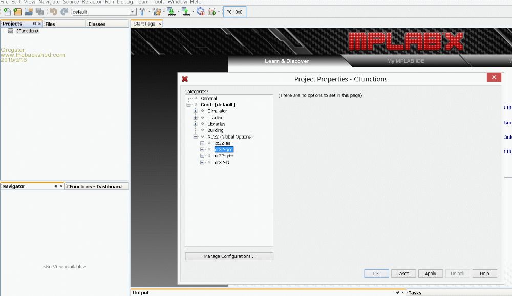

I get no such options under xc32-gcc:
Posts: 12182
Posted: 04:40am 16 Sep 2015
What do you get when you click on "Conf:[default]"?
Posts: 10109
Posted: 04:46am 16 Sep 2015
This is what I get:
Posts: 12182
Posted: 04:51am 16 Sep 2015
That looks OK. Does the project compile (hammer with brush)? Which version of MPLabX are you running? if less than 2.26 then upgrade.

I have managed to open the C file, or one of them anyway! (there's a few files inside the project - not familiar with X files.)
MPLAB is very sluggish - is this normal?
It does open the project, but it takes ages, and navigating around the application is sluggish - like working on Windows 95 again.....
Quad-core 2GHz machine with 8GB RAM and Win8.1 x64, if that helps.
What's with the red line down the middle of the code window?
EDIT: Version 2.0. I will upgrade as you suggest. Will be tomorrow - it's 2:53AM, and I should be resting my brain, not stressing it out!
Somewhat anticlimactic, yes, but goodnight - will follow up with this tomorrow. Edited by Grogster 2015-09-17

The redline is just a right margin indicator, can be turned off.
Tools->Options->Fonts&Colors->Highlighting->Text Limit Line then set the color to white (or whatever your background color is).
Definitely upgrade to a later version.

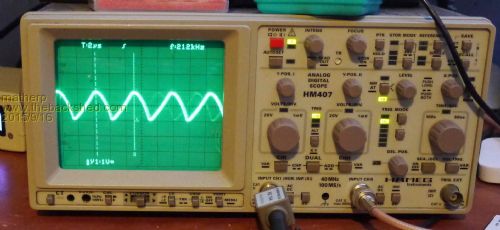

From the PIC32 manual we can see that the reference voltage will be output on pin 25 of a 28-pin MX170 and pin 14 of a 44-pin part. Page 23 of the MX470 manual says the reference will be on pin 23 of a MM+ (untested)
My test program looks like this:

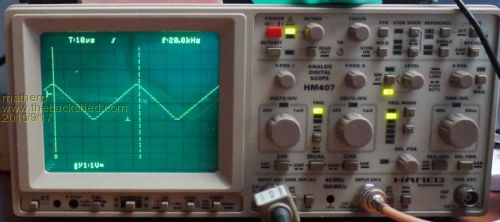

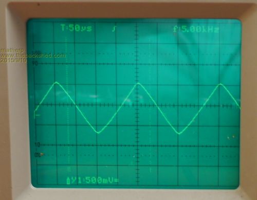

On my Scope I get a rough triangle waveform of 2V amplitude and frequency of 212KHz
Next post I will look at setting a specific frequency for the output

} else {
// ramp down
step = 31 - ramp;
CVREFOpen( CVREF_ENABLE | CVREF_OUTPUT_ENABLE | CVREF_RANGE_LOW| CVREF_SOURCE_AVDD | step );
CVREFClose(); // Disable CVREF (not executed)
return CurrentCpuSpeed;
Replace the earlier version in cfunctions.c with this code, recompile and test it .
My version is:
dim i%=triangleout(10) ' run for 10 seconds
print i% ' CPU speed
end
CFunction triangleout
00000000
3C029D00 8C420000 8C420000 00021042 8C830000 70431002 00001821 40834800
0062182B 50600013 34038000 3C07BF81 24060020 2408001F 40094800 00001821
10000003 00002021 01032023 0065200B 34848060 ACE49800 24630001 1466FFFA
2C650010 0122182B 1460FFF3 00000000 34038000 3C02BF81 AC439804 3C029D00
8C420000 8C420000 03E00008 00001821
End CFunction
