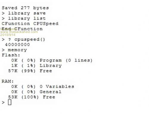

Posted: 06:08am 14 Sep 2015
spotted a small error in the manual, where reference is made to DS1703 instead of DS1307 in several places.
and i see a factory reset does clear the library contents - is this as intended?
given that there is a LIBRARY LIST command, that lists the basic statements in the library but not cfunction contents, how practical would it be to include reconstruction of the cfunction source? and, if this were possible, would it then be viable to consider adding in a LIBRARY EDIT command?
or am i looking too far ahead!

  robert.rozee said  spotted a small error in the manual, where reference is made to DS1703 instead of DS1307 in several places.
Thanks, the updated manual is in the beta zip file.
  robert.rozee said  i see a factory reset does clear the library contents - is this as intended?
Yes, there may be something in the library area which could stop the Micromite from reaching the command prompt, so you need some way of recovering.
  robert.rozee said  given that there is a LIBRARY LIST command, that lists the basic statements in the library but not cfunction contents, how practical would it be to include reconstruction of the cfunction source? and, if this were possible, would it then be viable to consider adding in a LIBRARY EDIT command?
The LIBRARY LIST command deliberately does not reconstruct the CFunction contents so that the user can see exactly what is in the library. Editing the library would be rather complicated and goes beyond what the library concept is supposed to be (ie, fixed code that does not change). The idea is that you debug and experiment with the library code as a normal BASIC program. Then, when you are satisfied with it, save a copy somewhere else and execute LIBRARY SAVE.
