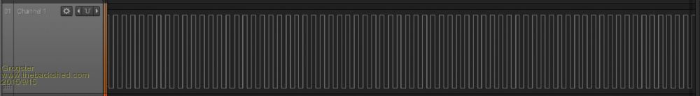

Posts: 10109
Posted: 09:33pm 14 Sep 2015
I am not getting ANY results, in any way, in any configuration, on any of the fansinks I have. These fansinks are all exactly the same.
So, I hooked up a Cooler Master PC cooling fan, and I do get a result from it:
This is what I would expect to get from the other fans, but don't.
I get no output at all. No response on rising or falling edge trigger, low or high pulse-width triggers.

The image above, is with a 4k7 pull-up to 3v3 on the tach wire, and I just unplug the fan, and put one of the other fansinks I am trying to make work, in it's place, so exact same testing conditions, but no output at all from the fansinks I need to work - go figure.....

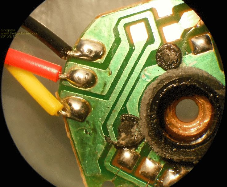

Posts: 10109
Posted: 09:55pm 14 Sep 2015
Well, this would explain quite a-lot........
There is a small chip inside the fan, but it is connected to the stator, and so I thus conclude that this chip is the driver for the fan, but there simply is no hall-effect sensor IC inside the fan at all - despite the yellow wire being there - good ole eBay......
I will just swap the fan for one that DOES have a tach wire. A working tach wire, that is.
