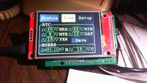

I was working with the spin-box object and set it up to display 0 to 8000 with 0.1 steps.. After some play time, I discovered that after holding the UP arrow a bit, the box starts returning numbers with 3 digits past the decimal point instead of the 1 digit I set it up for... Is there any work around for this... The displayed number gets to long for the box and doesn't display right....

Probably a floating point rounding error in the value of 0.1 which accumulates after repeated "spins"
include some code like (untested)
i%=CINT(CTRVAL(#ref)*10.0)
CTRVAL(#ref)=i% /10
to run after each "spin" or every n "spins"Edited by matherp 2015-09-14

I was using the "touch-up" INT for processing and was missing the "touch-down" INT's coming from the spin-box while holding down the "up-arrow" button... I put in your "steering" code if the INT found the object to be the spin-box on "touch-down"...
Works like a champ..!
Thanks Matherp..!
