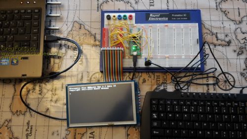

General layout and showing it being powered from my laptop usb port.

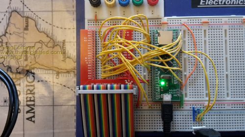

Closeup of breakout board and E64.

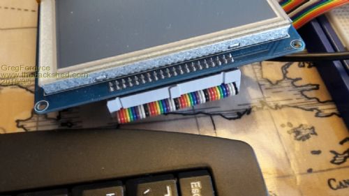

Make sure the cable is connected with the tab facing out as shown. Because the 5v0 and 3v3 pins are tied together if you try and connect it with the cable the other way round you will short 3v3 to ground! This way it doesn't matter about the tied pins becasue they are connected to unused pins on the ssd1963.
