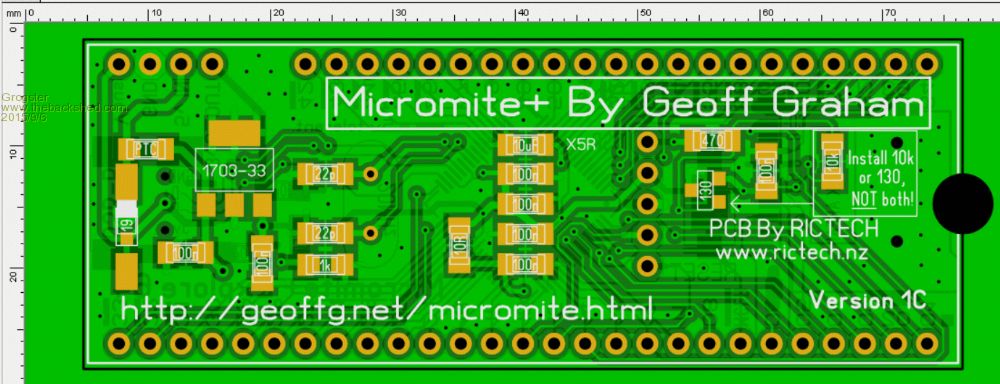

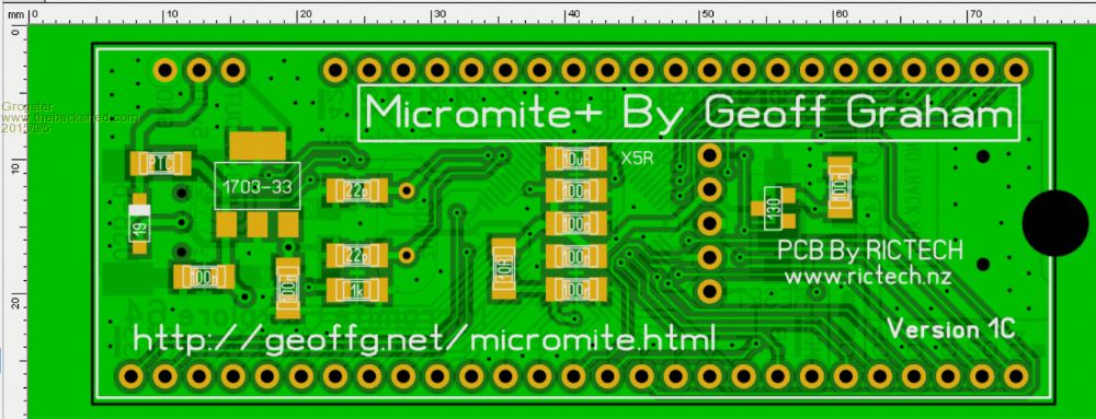

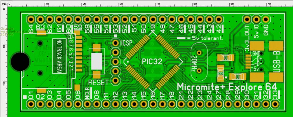

This is the updated PCB for the MM+ module.
TOP LAYER:
BOTTOM LAYER:
This revision of the board has the following improvements/changes:
- 10k pullup to MCLR replaced with 130 supervisory IC on bottom layer
Supervisory chip increases the unit price by about 50c, but this may well prevent any more of those hiccups that have been reported here with power-up flash corruption during the beta testing phase.
- SOD123 Diode(1N5819) added in series with USB power to protect against external power
This will block an external 5v supply from trying to go down the USB lead, if the USB cable and an external 5v supply are connected at the same time. Both the USB or external supply connection are via the PTC.
- Mini USB-B socket swapped for a much more common footprint available just about anywhere
The new footprint supports USB sockets that can be had from just about anywhere, rather then the special short one that has been used, which seems to only ba available from Element14. You now have more choice on where you get the USB socket from.
- All 1206 SMD have 0805 overlayed on top, so people can choose either 1206 or 0805 components
Most of the passive components are now dual-footprint, so that those who wanted to be able to use 0805 parts, can now do so. The board is still completely compatible with the 1206 size too, either size can now be used.
I think this covers all the issues mentioned by beta testers thus far, yes?
If anyone sees I have missed something previously discussed, please let me know.

OK, I have made the changes.
TOP LAYER:
BOTTOM LAYER:
Additions:
- Standard through-hole diode allowed for on USB. Surface mounted on bottom. Now you can use either a standard through-hole diode with legs bent, or a SOD123 SMD type.
- 470R resistor between reset button and MCLR on ICSP. Both 0805 and 1206 footprint.
- Choice of either the MCP130 or a standard 10k pullup for MCLR. 0805 and 1206 footprint.
How we doin' now? (in any event, I am off to bed. ten past 3 in the morning - I must be freakin' mad......)

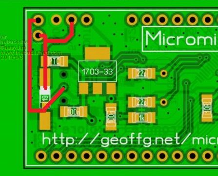

Posted: 04:51pm 05 Sep 2015
@Grogster,
I know my ramblings would confuse, they confused me.
TZ wants a jumper to short out the diode (to reduce voltage drop)
If the jumper was placed as TZ indicated with one pin inline with the other pins, users would have three choices.
1. Leave the pins out and go with the diode.
2. Put the jumper pins on the top side to allow a jumper to be placed on as required.
3. Put one pin on the underside in line with the other power pins and let their external circuit make the connection as required.
Option 3 with the diode left off allows all sorts of fancy power switching devices to be used.
The pins could be labeled 5V USB, Gnd, 5V in, 3.3V out
I think that TZ only wants to use the jumper to supply the full 5V to external devices. If so, only the one pin (in line with the existing pins) is required.
JimEdited by TassyJim 2015-09-07
Posts: 10109
Posted: 04:59pm 05 Sep 2015
OK, thanks Jim, I understand that now.
I will make the changes.

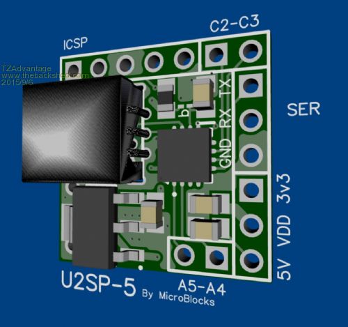

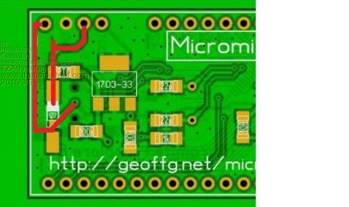

Posted: 08:47pm 05 Sep 2015
This is what i did on my USB to serial module.
It also brings out the 5v from the USB and the 3.3v from the voltage regulator.
The middle pin is called VDD and that supplies the PIC16F1455 with power.
It can be used with a jumper, or an external circuit can make that connection.
Errors can still be made. Can not stop that. When someone applies 5v to the 3v3 line it will cause problems too, so some responsibility has te be with the one who use it.
Making it clear is our job, the rest......
Tassyjims suggestion is the most clear. You will have a 5v output and a 5v input.
A jumper will in that case not be necessary as it can be on the external circuit.
And just to make sure we mean the same i include the picture.

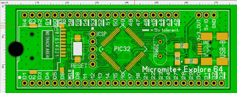

UPDATE:
TOP LAYER:
BOTTOM LAYER:
This should just about do it.
Are we missing anything else?

Posted: 10:54pm 05 Sep 2015
This is just nitpicking so feelfree to ignore it.

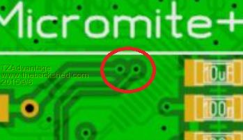

These two vias are very close together. When you move them away from each other a bit more then the ground planes will be connected a bit better.
@TassyJim, As long as there is no capacitor from MCLR to GND then a Supervisory chip does not prevent the pickkit3 from working.
Edited by TZAdvantage 2015-09-07
