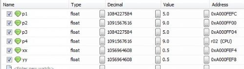

I'm getting stuck on a silly part with decimals on my ZZ calculation. I'm getting the "weight" of where my datapoint is compared to its axis, in the example above, I'm more bais/weighted towards p3 and p4. Using variable xx/yy in my code, which will hold a float value between 0 to 1.
MPLAB just stops while debugging the calculating of zz. "Unknown error while attempting to unwind callstack! User program stopped"
The answer ZZ = 7
