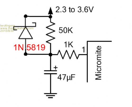

  twofingers said  Do you think a "Delayed Start Up" (as described in the MMBasic manual) will do the same?
Yes, something like that would work for WW's particular problem although you would need to add a diode to quickly discharge the capacitor when the power momentarily failed.
There are many ways that the power can cause issues and many solutions. A supervisor chip is one of the better solutions.

Posted: 12:32am 30 Aug 2015
  Geoffg said  Yes, something like that would work for WW's particular problem although you would need to add a diode to quickly discharge the capacitor when the power momentarily failed.
A schottky diode? In this way?
(Note: Image mainly from Micromite MMBasic Ver 4.7 Beta Manual)
Michael
Edited by twofingers 2015-08-31
