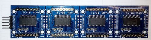

I have been playing around with some 8x8 matrix LEDs with MAX7219 driver boards and thought I would share some of the code. This program borrows from others on TBS and references to those threads is listed in the program. This program is 100% functional, but I would also still call it incomplete. It shows off some scrolling text then shows a clock display, but there is not any facility to directly enter any text or manually set the clock.
The font used is entirely my own work and is a proportional font. Why use a proportional font? Because I wanted to squeeze 8 characters on to 5 LED modules. And why is the font table in binary? Because I'm still "tweaking" it and it's easier to make changes on the fly with the binary. I will convert it to hex later.
Demo of clock
What do you get when you replace the font? Halloween Eyes! This is just a preliminary test and needs lots of work.

Hi Curtis,
I had my Max7219 `panels' arrive today but unfortunately they seem to be wired differently to yours.
The effect is the RHS panel scrolls text sideways (going UP ie. like the panel is rotated 90degrees clockwise) and all the other panels are solid RED..
It is rather weird ... with 4 panels connected (they come in 4 joined) there is no intelligible text on that RHS panel but when I connect 8 panels together the RHS distincly shows the moving message board string on the RHS panel but rotated 90 degrees and scrolling up.
Do you have a pinout of your panels? I can then buzz out mine and see what is different.

OK, firstly I had my displays powered by 3v3 instead of 5V.. Now all panels `work'
BUT it looks like my modules have the rows and columns swapped as the text chrs are all rotated 90degrees to the right .. Is there a simple way to modify the code to work with these panels or have I blown my 2 and 1/2 shekels I paid the little Chinese Gentleman.?

Hello Mick.
I was wondering when someone would ask that question. There at least three different 7219 matrix modules with the 3mm LEDs. Two use surface mount chips a one uses the dip version of the 7219. I have used the two which have the surface mount 7219.
Looking at the back of the module, if you can see the 7219 chip and the are jumper pins in all four corners. Rotate the module so that pin one of the chip is in upper left, both vcc pins will also be on your left. The input connector runs along the bottom and the output is at the top. The next module in the chain will go on right. You can hold the modules together with the corner jumper pins.
If you don't see the 7219, position the module so the silk screened 'IN' is in upper right corner. The input connector will be across the top of the module anf the output is across the bottom. The next module goes on the right. I used a bamboo skewer and twist tie to hold the module together.
I opted for this orientation to reduce the amount of slicing a dicing of bit inorder to display a character. I did try the other way and it was SLOW.
I hope that helps... I have to stop now, I'm typing this message on my old Kindle 3 and it's killing my thumbs.
--Curtis

Hi Curtis,
These are my Modules
They are 4 modules on the same joined PCB that needs to be cut to separate them. They are prelinked at the joins with solder tracks.
From eBay as shown in this link Ebay link
Note the picture shows them linked by shorting blocks.. they are all on the same PCB ... solid..
I have also bought some from elsewhere that have not arrived yet.
EDIT ***
The picture is compressed too small to see. I have ZIPped it up here 2015-09-18_080314_Max7219.zip

Mick, those modules (FC-16) are the second of the two I descibed. The modules I received were not fully assembled and I had to solder the pin headers on. I originally connected my modules in the same fashion as yours, but found my program was a bit to slow (the clock would fall behind when scrolling all six digits). I'll post the links to the modules I used when I get to a real computer.
