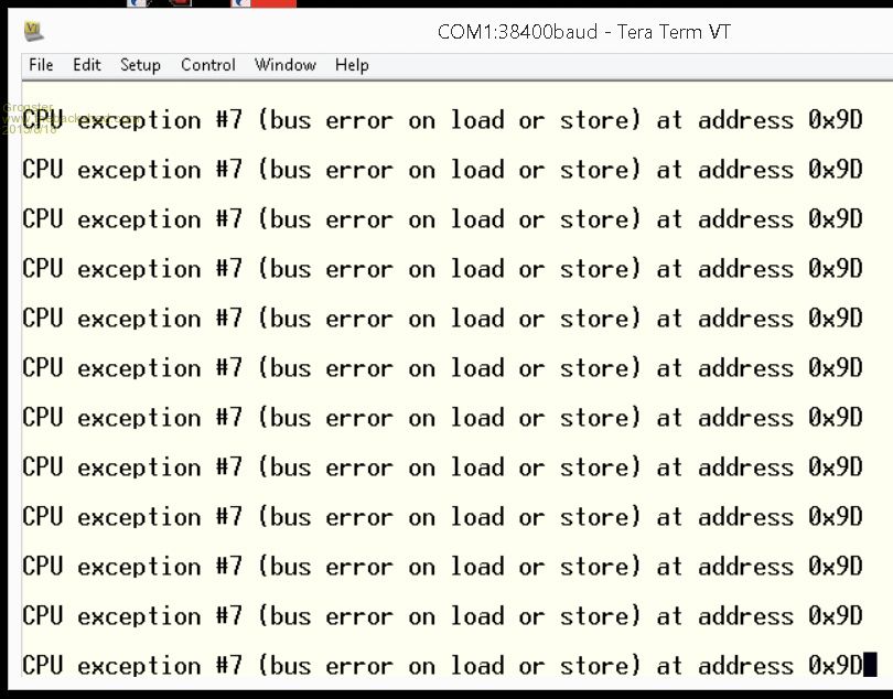

Also when I configure TOUCH with ' OPTION TOUCH 18,14 ' I get the message to restart the MM+. When restarted I get an error message that just scrolls down the screen. Ctr C will not stop it nor will a reset and if I power down and on again the error message re appears. The only way to get rid of it is to re flash the chip. I have checked all my connections pin to pin and all is OK.

If it is anything like this:
...then that seems to happen if you cross-assign pins to things - perhaps by mistake.
I got this error message during alpha testing, and there was NOTHING you could do to stop it. Once it happens, you have no choice but to reflash, as resetting or cycling power does nothing, and it just starts coming up again all the time.
This may not be the exact error code you are getting, but that is the fatal error that happens.

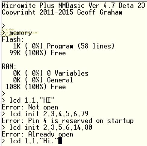

As to the SD card, ANY module I have supplied, ALWAYS has the SD card enabled by default, so there is no need to enable it again, and enabling the SD card when it is already enabled(or cross assigning pins with something else) will probably crash the current firmware as it is still in Beta testing. Beta-23 tells you if you are assigning a pin to something already assigned:
