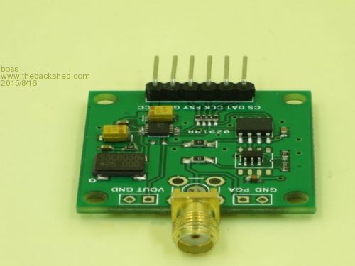

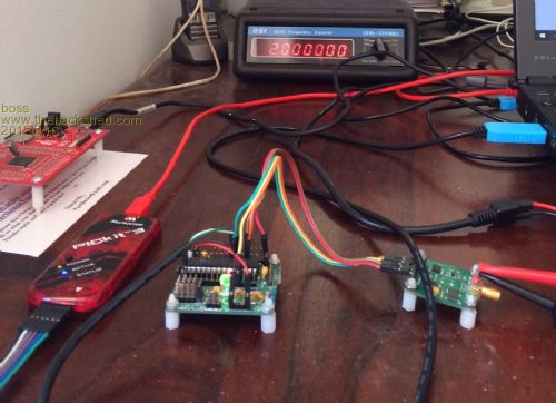

If someone of you is interested to build nice DDS Signal generator cover 1Hz to 12.5Mhz for less than $10, there is description how to do it:
Couple weeks ago I found nice AD9833 module with amplified output on eBay for $9.50 and free shipping. Simply connect the module with uMiteII via 3(SPI) wires (see instruction in DEMO programm) and 5V power, download the enclosed "DEMO" and enjoy.Because of DDS you must add the LP filter to reconstruct signal properly. Right now I'm working on LP filter design.

I am about to show you how naive I am right now...
What is the LP filter that is required and does this need to be different for every signal generated?
Hey!!! I see one of my MuPs in that picture...
Nice work.

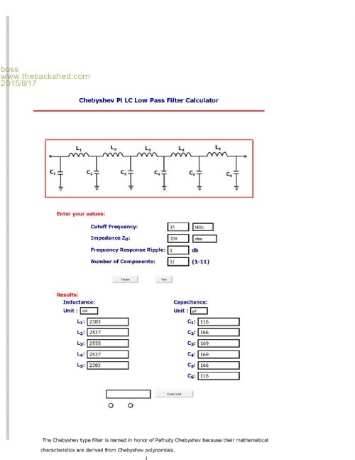

LP filter means Low Pass filter and consist of 5 inductors ~2uH,6 capacitors ~250pF and one resistor 200 Ohm. The design is finished but LP response need to be verified with signal generator and oscilloscope.
Hopefully I can do it till end of this week. LP is connected to the DDS output connector.

@Bigmik
there is the filter design
Bo
Posts: 2984
Posted: 05:15pm 16 Aug 2015
Ho Bohumil,
Is that in series with the resistor?
What sort of voltage level with this module put out?
boss
Joined: 19/08/2011
Posts: 268
Posted: 05:57pm 16 Aug 2015
@bigmik
No parallel to C6, but instead resistor I'm considering to use 200 Ohm potentiometer allows you control desired output level. For frequencies 1Hz-6250000 the output level is stable higher frequencies goes down with amplitude.

Posts: 268
Posted: 06:43am 17 Aug 2015
@bigmik
MuP is a perfect tool for testing and development purposes. I really like it.
To the module signal: AD9833 can generate sinus, triangle and square signal. Sinus level p-p is around 3V for frequencies up to 6.25MHz, for higher frequencies the p-p level goes down. As simple and inexpensive signal generator is good enough. And there is possibility to ad another functionality ie. sweep generator just write the code.

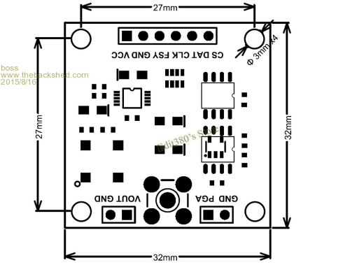

I've been searching many forums and this post is the first I've found that uses the exact module with a AD9833 plus on-board amp that I have.
I realize this is an old post, but I'd appreciate any information you have. I'm confused on the pin interface to the module and can't find any documentation other then for the AD9833 alone.
The module has both SS/FSY and CS pins. Normally if there are multiple modules on the SPI bus, you just set each module with a different SS control pin to avoid collisions.
Do you know why there are both SS and CS pins? Did you find some module specific documentation or just experiment? If you found documentation can you provide me a link?
Also you set CS to HIGH and SS to LOW to set the registers in the AD9833 and then SS back to HIGH at the end of the set up. Why is CS HIGH - rather then a standard SPI setting of LOW to trigger module processing of the data?
Thanks for any information.
Lee
Posts: 3372
Posted: 04:26am 23 Apr 2017
Welcome to the forum Lee.
The SPI interface has two chip select signals - FSY which, when taken low, addresses the AD9833 and CS which addresses the MCP41010 digital potentiometer (which is also in the module).
