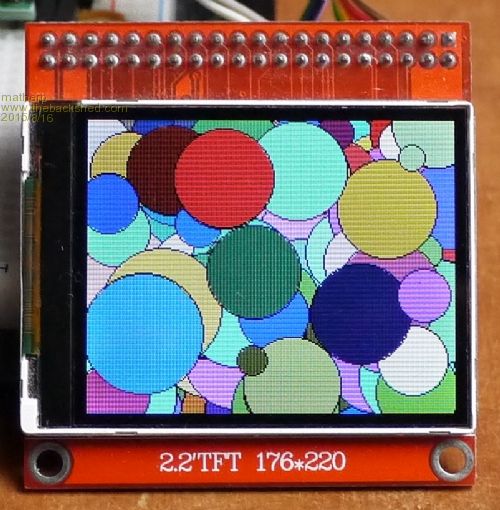

This post has code for the 2.2" 176x220 displays based on the S6D0164 graphics chip. These displays have the advantage of being very fast to drive with an 8-bit parallel bus and very bright.
Note that pins DB8-DB15 are used on this display for the 8-bit databus connections.
The code includes optimisations that increase performance on the uM+ if the pins designated LCD_D0-LCD_D7 are used for DB8-DB15 as in the example code below
The code is also optimised if pins 25,26,27,36,37,38,2,3 are used for DB8-DB15 on a 44-pin MX170. In this case pins 4 and 5 must be left unconnected.
Otherwise performance is still good with a completely free selection of pins on any of the uM2(+) variants.

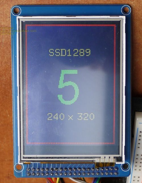

Next driver is for the SSD1289 typically seen in 3.2" 240 x 320 versions
This has a 16-bit parallel interface + 3 control lines (RS, WR, and RESET) so although it is theoretically possible to use on a 28-pin uM2 it is more useful on the 44-pin uM2 or UM+.
Note that the basic mechanisms of the routines to set up the display are identical to those for the S6D0164 and Peter Carnegie's SSD1963 driver.
These displays also support touch input. To use the inbuilt touch mechanism with the loadable display is easy.
Run the attached program but comment out the line:
Retrn%=Display.Close()
Once the GUI TEST DISPLAY is running (lots of circles) press return on the console to stop the program. This will leave the display driver loaded and operational.
Then enter "OPTION TOUCH cspin,irqpin" substituting in the the correct pin numbers.
Finally enter "GUI CALIBRATE" to calibrate the touch system.
Now you can reset the processor and the touch characteristics for your display will have been stored.
You can now run your own program using the loadable driver and full touch input support as per the in-built drivers
