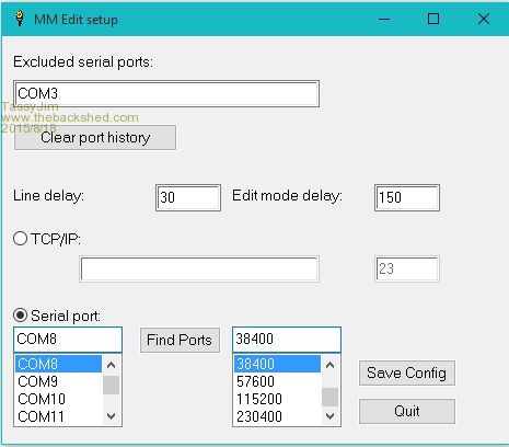

Posted: 09:38pm 17 Aug 2015
An update for WW and Grogster to test.
@WW
White space is also removed on lines with comments removed.
You might be happier with the wording of "Remove Leading and Trailing spaces"
#Grogster,
Still no idea why you are having problems with your "real" com port.
When you go to Connect/New...
There is an option add a list of com ports you want excluded from searches. The list needs a space between ports. eg "COM1 COM3". Remember to "save" before exiting.
This is handy if you have a modem or other device you want left alone.
Currently, you can still select the excluded port manually but I will probably stop that as well.
Below that is a button to clear all connection history.
I need to tidy up the layout a bit and update the help before releasing a full update.
2015-08-18_073526_MMedit.zip

Posted: 10:43pm 17 Aug 2015
@Grogster,
I think I have found the problem.
I need to do a few more tests but it sort of makes sense.
Posted: 10:54pm 17 Aug 2015
@Grogster,
Try this one:
2015-08-18_085120_MMedit.zip
I still have more to do but I would be interested to hear how the one goes.
The file manager sends a ctrl-C and waits for a response. Now it tries 10 times and then gives up in disgust.
Posts: 10109
Posted: 10:59pm 17 Aug 2015
That works!
If I do exactly the same as above, instead of the connection window locking up, it reports that it did not get a response from the device.
As soon as I click OK to that, the window closes, and everything is fine.

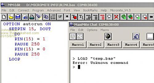

Posted: 07:55pm 18 Aug 2015
I've tried to use MMedit to send the simple program to a PIC32MX150F128B.see attached
If I use tera term it works ok.
If I try the same using MMedit the error msg appears when I try to send/prog.
As far as I can find there is no "temp.bas" file anywhere.
the program seems to load and save ok, but nothing keeps happening.
Help please
Johnande
