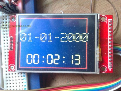

MMBasic 4.7 for the Micromite, "MM", has 2 built-in fonts, and does not support loading other fonts from the SD card unlike the MM+.
However any device running MMBasic 4.7 B23 or later can load different fonts using CFunctions.
In the example below, the 2 built-in fonts are replaced by a 7 Segment font and a Dot-matrix font, and then the usual MMBasic TEXT and FONT commands can be used to write to the LCD Panel using the new font.
You do NOT need to compile/write 'C' code or CFunctions to use this loadable font feature. Pre-compiled fonts are available for download from http://www.mmbasic.org/fonts/index.html.
To use loadable fonts in MM MMBasic, you must download and append the InstallFont CFunction from http://www.mmbasic.org/fonts/InstallFont.bas onto the end of your MMBasic program, then download and append your chosen font from http://www.mmbasic.org/fonts/index.html onto the end of your MMBasic program.
To install the font, you first obtain the address of the font CFunction using PEEK(CFUNADDR FontName) and then call InstallFont with that address and the font index, ie 1 or 2. Thereafter, you just use the usual MMBasic 4.7 TEXT, and FONT commands, eg
DIM FontAddr%=PEEK(CFUNADDR SevenSegNumFontPlus)
DIM Retrn%=InstallFont(FontAddr%, 1)
I will be adding further pre-compiled fonts at http://www.mmbasic.org/fonts/index.html, but please feel free to contact me if you want a specific font compiled.
I will also be updating the CFunction Tutorials to include a chapter on how to compile CFunction fonts - it really is very, very simple, and requires NO C language experience/knowledge - in fact if I get the time I might add a utility to CFuncGen which will take in a font file and generate the font CFunction.
The example MMBasic program which demonstrates font CFunctions is shown below - copy and paste to try it out. The test program is also available from http://www.mmbasic.org/fonts/CFunctionFontExample.bas - NB watch out for the Bulletin board changing the code below

PRINT "Installing SevenSegNumFontPlus as Font 1"
'Get Address of SevenSegNumFontPlus font
'Get Address of DotMatrix_M_Slash font
PRINT "Installing DotMatrix_M_Slash as Font 2"
FontAddr%=PEEK(CFUNADDR DotMatrix_M_Slash)
Retrn%=InstallFont(FontAddr%, 2)
'Use Font 2 and scale x2
Font 2,2
'Yellow FG, Dark Blue BG
Colour &HFFFF00,&H000066
'Clearscreen
CLS
'Draw a Red Frame
Box 0,0,MM.HRes-4,MM.VRes-4,4,&HFF0000,-1
Text (MM.HRes/2)-115,(MM.VRes/2)-100,"ILI9341"
Text (MM.HRes/2)-140,(MM.VRes/2)+60,STR$(MM.HRes)+" "+STR$(MM.VRes),,1,1
Text MM.Hres/2 - 20,(MM.VRes/2)+60,"x"

'Calculate the width in pixels of TIME$
'The 7Segment font is 32 pixels wide
DIM WT%=LEN(TIME$) * 32
DIM WD%=LEN(DATE$) * 32
'7Segment Font is 50 Pixels high
DIM H%=50
DO
Text (MM.Hres/2)-(WT%/2), (MM.VRes/2)+H%,TIME$,,1,1,&HffFF00,&H000066
Text (MM.Hres/2)-(WD%/2), (MM.VRes/2)-H%,DATE$,,2,2,&HffFF00,&H000066
PAUSE 500
LOOP
END

When you run the demo program, on an ILI9341, you should see
Hopefully this new MMBasic 4.7 capability will be interesting and useful
