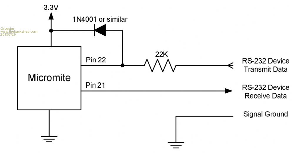

Hi folks.
With respect to this diagram from the MM manual:
I don't follow the logic(pardon the pun) of this arrangement.
Manual says that when RS232 from the PC or other 232 equipment swings to +12v, the diode will clip the voltage.
HOW?
With +12 from the 232 on the line, the diode will be forward biased, and both the MM input pin, and the 3v3 rail will see a 12v pulse.
Surely that is not a good thing for a device not to exceed 3.6v absolute maximum.
Obviously, there is something I am not understanding here, so I would love someone to help me follow this idea, cos I want to use it, but I don't want it to destroy the MM as soon as I put the 232 on the other side of the 22k resistor....

Think about what the resistor will do.

You mean along the lines of a potential divider at the point between the diode-side of the 22k and ground?

Grogster,
That works the same way that the protection diodes work for 5v..
You are not supplying a 12v power supply to the diode but a low current through 22k resistor so you will have 3.6 v on the anode side of the diode and (up to) 12v on the RS232 side of the resistor, the vcc supply to the pic will easily disperse any effect the low current would try to inject.

...but when the 232 line goes to 12v, BECAUSE of the high-impdeance of the input pin, that pin would therefore see the 12v pulse, would it not?

A problem with this circuit is the line will also swing NEGATIVE so a diode should also be placed between the Rx pin and GND (anode to GND and cathode to Rx)
I believe there are these diode inbuilt on the pic pins but maybe not all pins have them

Grogs,
12v will not be seen at the pic because the diode will shunt it away to 3.3 which will not move so you will not see more than 3.6 v at the pic using.a schotky diode.
Mik
Dangerous?? Possibly if the diode fails or a solder joint fails but then the pic has protection diodes built in anyway...

The resistor limits the current to a very low level.
The output of the 3V3 regulator is very low impedance, I doubt it will shift at all due to the 360uA or so that comes down the resistor, it would not be much of a regulator if it did.
As mentioned the PIC already has its own diodes built in.

On the PIC32 all normal (not 5V tolerant) pins have a diode to Vdd BUT the 5V tolerant inputs do not have the diode, so this is why I included the external diode (just to be safe).
There is always a protective diode to Vss so this is why an external diode is not required for this function.

Thanks for all that, guys, I think I understand this now.
Asking any technical question at 12:45AM when you are almost asleep at the keyboard, is probably not the best idea.
I will therefore design this ciruit into the board I am designing for something, as it saves me having to have a 232 level shifter IC etc - PCB space is tight, so that will make my life easier if I don't have to squeeze the level shifter in there.

  Geoffg said   On the PIC32 all normal (not 5V tolerant) pins have a diode to Vdd BUT the 5V tolerant inputs do not have the diode, so this is why I included the external diode (just to be safe).
Hi Geoff, I think you should better recommend using a Schottky diode for clamping the voltage, because they have a 0.2 to 0.3 V dropout (instead of the 0.65 V of conventional diodes); this gives a 3.6 V (3.3 + 0.3) worst case maximun voltage on the PIC pin. I suggest changing the documentation to reflect this, replacing the 1N4001 with a 1N5819 or equivalent.
