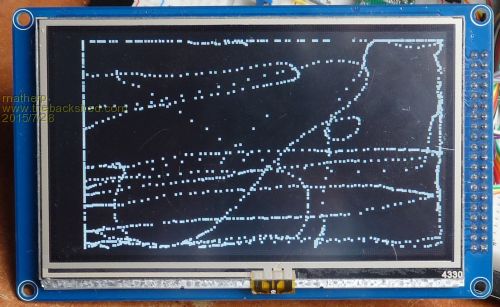

I've got a small issue re calibration of touch on the SSD1963. I'm calibrating with a stylus and accurately pressing and holding on the targets
On the 4.3" display when I use GUI TEST TOUCH, the spot follows the stylus nicely but won't go to the left edge of the screen
On the 5" display the the spot is correct on the left side of the display but progressively moves right of the stylus as I move across the screen. It remains correct up and down.
Has anyone else seen similar issues?

I've had a look at the code and am fairly certain there is a minor error in the commands sent to the touch controller. I've notified Geoff. Changing this will improve the touch resolution, particularly on the 5" and 7" displaysEdited by matherp 2015-07-29

With ssd1963 5" display and MMBasic V4.7B21, after gui calibrate with "no errors" I have a gap on the right side of the screen ... On the left, it's ok ...
https://youtu.be/zmMXUKCgGuY

Out of interest what happens if you configure the SSD with the opposite 'orientation' to what you currently are doing? i.e. if you have used L (landscape) then try RL (reverse landscape). Does this switch the 'gap' to the opposite side or does it remain in the same place??

With RL ... same result ('gap' on the right side of the screen)

With a ILI9341 display and the MX470 beta23, I seem to get errors when I drag the stylus outside the display area. The dot position is mirrored inside the display area.
If the stylus is 5 pixels outside, the dot is 5 pixels in from the edge.
This was on all edges.
This may be part of the same problem but if not, it isn't a major issue provided it stays close to the edges.

Thanks folks. I think that Peter has found the issue. Another thing to fix when I get back.
