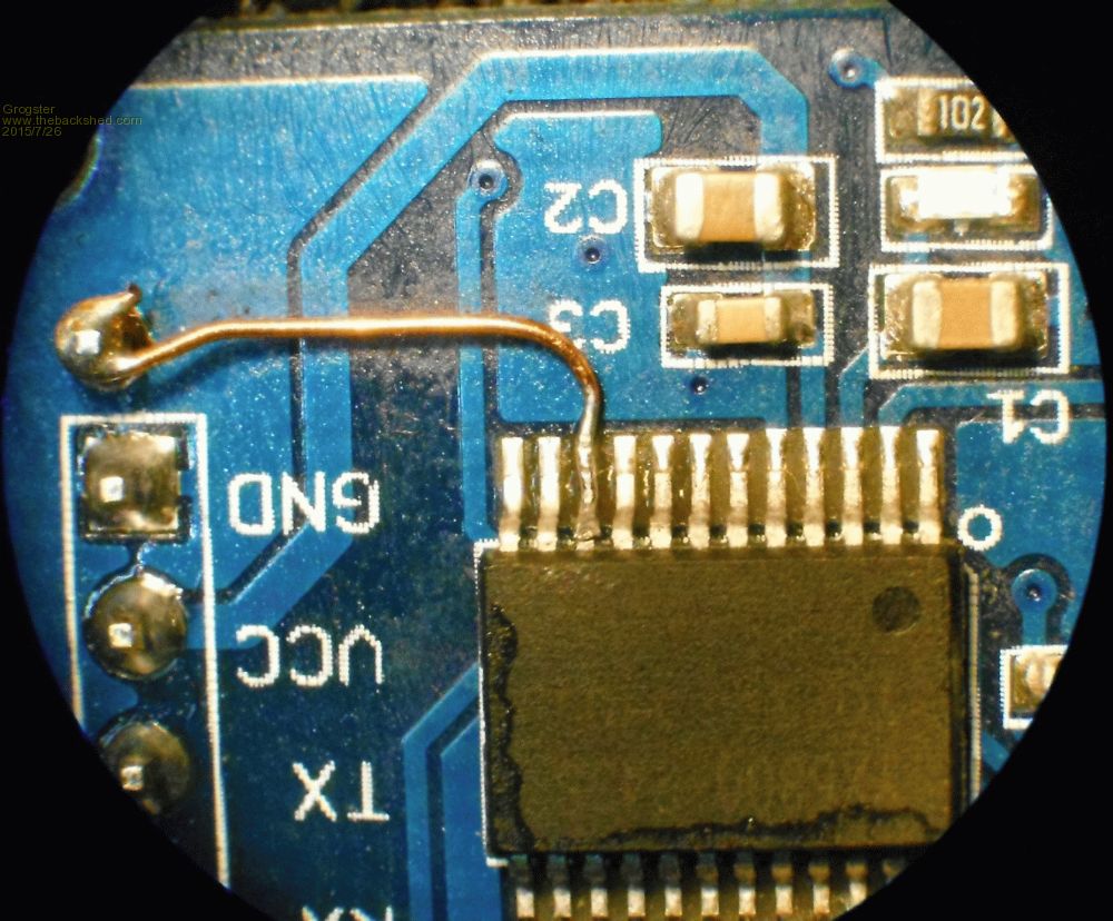

1) Remove existing pin-strip. I used Chip-Quik low melting point solder to remove the pin strip easily, but you could just lever up the little plastic insulator on the pin-strip, cut the pins, then remove the remaining pin with pliers and a hot soldering iron. Chip-Quik is neater though.
2) Mark the position for a 5th pin, and drill the PCB for this extra pin. Countersink both sides of the hole, to prevent the new 5th pin from touching the surrounding ground plane.
3) Install a 1x5 pin-strip, which restores the existing four connections, and adds one insulated one.
4) Add a very thin wire from pin10 on the decoder chip, to the new 5th pin on the pin-strip, and hey-presto!
You now have a BUSY line on the Catalex module, which goes low when any file is being played, and with that, your MM code can then detect when the module is busy or has finished playing a file. (this new BUSY line is normally-high)
Here is a photo of the mod from my microscope. The enamelled wire I used was 0.25mm

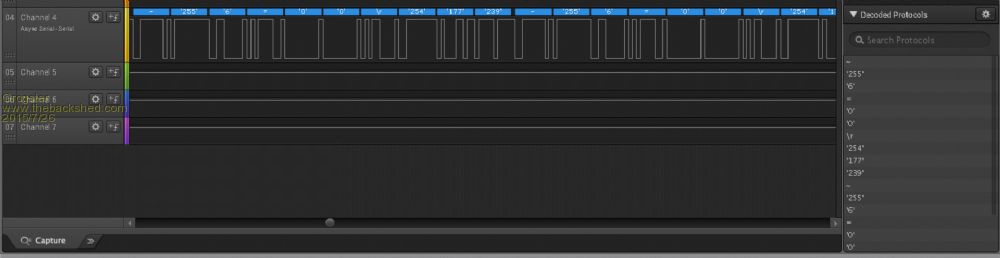

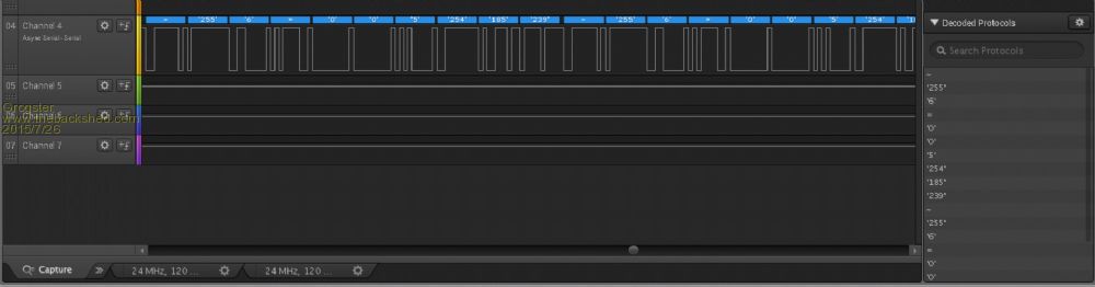

Yes, the module does definetly output several bytes at the end of each file played:
Three different files played, these are the bytes sent by the module at completion of playback, and the data is different for each one with the exception of the first few bytes of the message, which seem to always be the same.
I can't find any information about what any of this means though.....Edited by Grogster 2015-07-27

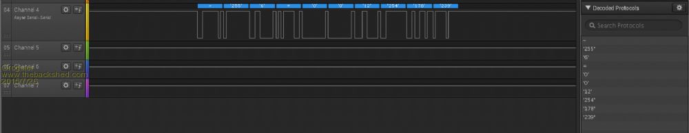

Here is a GIF of the output of the module in HEX as requested.
Note that this data changes with every file played, but the first few bytes seem to be the same. I must have a read through the manual that Rob found......
Catalex TXD GIF image example

I've done a fair bit of translating (google xlate) of the Japanese Manual
Manual example in HEX
7E FF 06 3D 00 00 02 xx xx EF TF card to play the first two completed
The GIF has (all hex)
7E_FF___________06__________3D_______00_00__0C_____FE_B2___EF
Std_start_chars___Bytecount___Command__?__?___Track__CRC_____Endchar
So this string seems to mean that the 0C th track has finished playing.
0C hex = 12 decimal.
So the 12th track has finished playing.
Could this be true ???
No warranty is implied.
John B
edit - I see that this example is in the Eng Manual from Robert.Edited by VK2MCT 2015-07-29

Posts: 10109
Posted: 03:01pm 28 Jul 2015
@ VK2MCT - Yes, I played track 12 for that test - well done, and that does correspond with the track I played for that test image last night.
