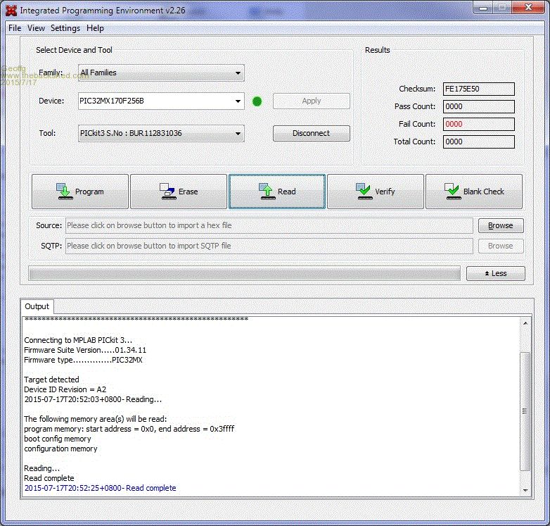

Posts: 3368
Posted: 03:02am 17 Jul 2015
I just tried reading a chip and it worked fine. Your error message might be hinting that you need to reinstall MPLAB X with a more up to date version.

Posted: 06:29pm 29 Jul 2015
Just as Geoff expected, I downloaded new IPE and THIS WORKS GREAT!!!!!
