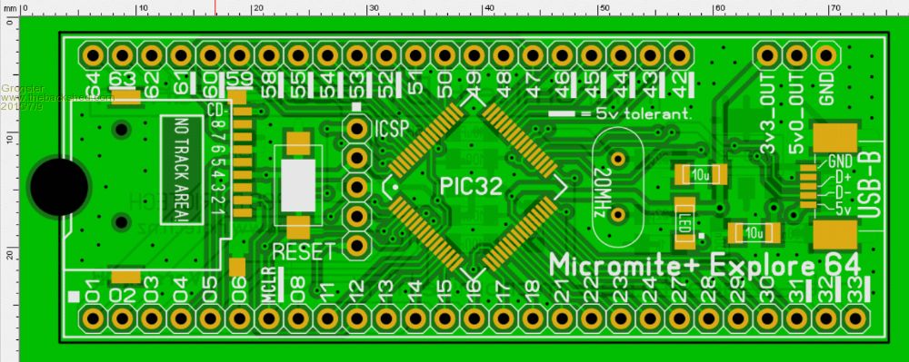

At Geoff's request, I have started a new thread for the board for his Micromite Plus, which was developed in co-operation with Geoff. I designed this PCB, but the entire idea and concept remain Geoff's - I just helped out with the PCB.
TOP LAYER:

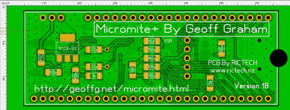

BOTTOM LAYER:

Hi Grogs,
Looks pretty cool,
Is that a SD card socket at the end?
What size SMD parts are they? Will 0805 fit there, I think they look bigger though,?
What USB connector is it? Looks like a micro USB instead if a mini USB ..if a mini then maybe you should have allowed for more copper area to solder the connector too.. Usually minis have 4 solder points for the case mounting.
Good looking PCB, keep up the good work.
Posts: 10114
Posted: 03:22am 09 Jul 2015
Hey buddy.
All parts are 1206.
MicroSD card slot at left end(push-in/push-out type).
Mini-USB "B" connector.
1:22AM - sleepy.
Will catch ya all on the flip side.....
EDIT: @ Mick - USB-B socket is a short type, not the long type. The short sockets only have two case mounting tabs, hence the two pads.Edited by Grogster 2015-07-10

Grogs, just eyeballing it the pads for the 1206 devices don't seem to be extended in a bit to make the use of 0805's easier - is it possible to do this on the next version? Guess the 10K resistor pads on pin 7 would be a problem with the three tracks through but that seems to be the only one.

  paceman said   Grogs, just eyeballing it the pads for the 1206 devices don't seem to be extended in a bit to make the use of 0805's easier - is it possible to do this on the next version? Guess the 10K resistor pads on pin 7 would be a problem with the three tracks through but that seems to be the only one.
Greg
I designed it for 1206. I know where you are coming from though, as you must have settled on 0805 series!!!
I have settled on 1206 you see, and have heaps of that size in stock, and practically no 0805 - go figure!
I will have a look at that idea for the next run of boards, as apart from that 10k(and I can probably move it), that would allow you to use 1206 OR 0805 - more appealing to many, as MOST people seem to be 0805 or 1206 size in my experience.
